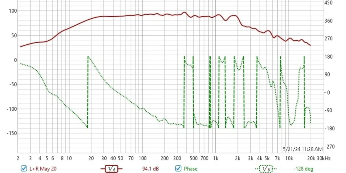

The data for the passive sub is not smoothed! You can see that on the upper bass! Hoffmans Iron Law? No more!
I provided a spectral response from the listening position with a 75Hz crossover in place. It is basically flat with no eq! It would measure that way from all room positions with small variations in response no nulls. If you can’t hear the nulls what is their importance. Don’t ignore the facts!
Do you have a technical employee that can join the conversation perhaps? All the graphs you have shared so far and all the graphs on your website employ significant smoothing.
The spectral response is also nowhere near detailed enough to prove anything. To have a somewhat flattish response in one listening position in a room isn't unheard of, so you either need to provide additional examples and with greater resolution, and/or show measurements of both this and a traditional sub in the same location and present differences between them.
I offered to have a member review the sub without paying! I don’t feel that a solution is wanted for these room issues.
Yes it is. 1/6th smoothing, and it is impossible to see anything in the upper bass, the graph has 10dB between each line.
And alongside the 300dB on the Y-Axis, the X-Axis goes from 2 Hz to 30,000 Hz.
Usually subwoofer plots go more to a few hundred Hz.
It can be likened to inspecting a tree leaf from a 100,00 foot high U2 photo.
