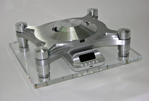

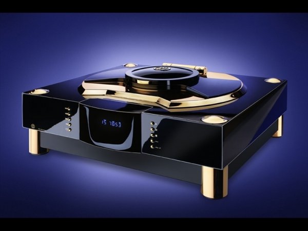

What about CD Players?
The Oracle turntable was always famous for its beautiful suspension system. Is the CD Player immune form airborne feedback?

It does appear to deal with mechanical feedback.
LL21
Dec 26, 2010
14,430
2,518
1,448
I think the MBL description of the MBL 1621 Ref Trasport specifically mentions that they have an enormously heavy, sealed lid on the top exactly for this reason.
