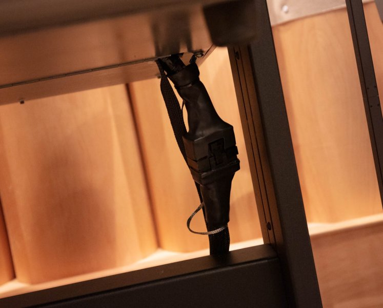

picture 3---close up of the left side 1/2" MR-70 ATR-102
picture 4---custom umbilical to power supply.

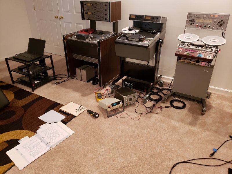

As a fellow MR-70 owner, I'll be enthusiastically following this thread to read about your ultimate opinion on the Nuvistor-based electronics. Despite a fair number of excellent tape machines and PB electronics having passed through my shop/audio room - the MR-70s have pretty much set a high mark (pic shows alignment of machines before recent shootout).
Much of what you'll read about the MR-70's development and production numbers is purely lore, but the performance the Ampex engineers were after was absolutely achieved.
-Tom

Martin Logans - Atma Sphere...and...more MR-70s. So yes - very familiar with their sonic characteristics. Anxious to hear what Mike reports back about his A.K. built machines.
