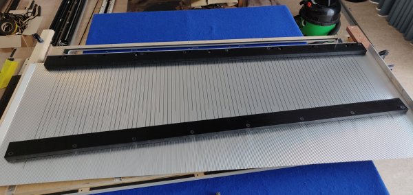

This seems to be the most salient thread so:
1) New bass ribbons. These have a different corrugation pattern than the last set and may be a bit thicker.
2) Clamps no longer MDF as per original but another material that costs quite a lot. Many times more than MDF. Was never too keen on MDF as a material for the clamps.
3) Clamps held to the chassis in a much more secure manner than previously.
I personally think this set up should be quite a bit better due to it being a much more solid setup. It wouldn't surprise me if volume capability is enhanced. In fact I am sure it will be, just not by a huge amount.
Anyway, you can't really see much apart from some black bits and some foil, so it's not giving away anything that can be regarded as confidential.
You can't underestimate the importance of making planars in as solid a manner as possible. This is another step in the right direction. Easy does it;)
They are just sitting there waiting for stuff to dry out before the top and bottom clamps are added. The MRT unit also needs to be put back on and a few other bits and bobs.
Looking forward to the results post break in.
This clamp material is also in Kim's Scintillas, for those that know of him. There may be a thread on them soon just not sure where.
The clamp material is made by the company my long deceased father used to work for, which I think is a really nice touch:) Jon and I where discussing what to use about a year back. It was actually a materials expert that recommended it.

The clamp upgrade has paid off. I had my family round this weekend, and we watched "The Dirt" on the 4K UST projector via Netflix - loud.
How I know that's not purist audiophile, but as my brother said "that really does sound very good". And he was right.
So essentially the speakers now sound better than they ever did by a good margin. I usually yawn a bit when I hear about upgrade XYZ improving people's systems as you never really know what the hell they are on about. You have to hear their system to know if it isn't bullshit. But whatever FWIW (not much LOL) according to me this is ace.
So what facilitates the improved bass definition? Probably the mass of the clamps and the fact that the material itself is "deader" than wood. And you can hear that easily. There's also far less sign of reaching the limitations of the bass panel when the volume is cranked up.
That said, there was an issue with the bonding of the aluminium to the Kapton. This was only really evident when playing certain material as it would excite this lack of bonding only when the amplitude at a certain frequency range became sufficient. Since we knew we had to replace the bass panels, I thought we had an opportunity to upgrade the bass panel clamps, and that is what initiated the investigation into using the material we did.
So there are two potential issues with Apogee buzz. Rotting foam on the clamp surrounds (not an issue here), and also separation of the foil from the Kapton. Or mylar in other designs.
I would strongly recommend anyone getting a refurbishment to use this material.
That said planars are a pain. Martin Logans (I went through multiple panel changes with mine) Apogees and others. They all need maintenance to keep them at top performance and always bear this in mind. If you have ears you will know when they start to drop in performance and just simple signal generator sweeps done slowly will easily isolate resonance faults with simple FR tests telling you how panel performance alters over time. Which happens in all panel designs using membranes I would bet.
Just being honest, principally because it's true.
