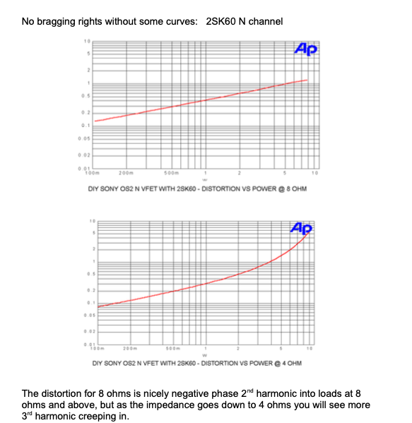

I have been listening for nine months or so my Pass DIY OS2 single ended amp based on the ancient Sony 2SK60 VFET, that I built into an old, defunct Sony TA 4650 chassis as a kind of tribute.
It seems to be a ‘current amplifier’ spin on the commercial SIT 1 and SIT 2 amps, since those had both voltage and current gain in the single SIT device while the OS2 has only current amplification and requires voltage amplification from a preamp stage. Every voltage amp I have tried, both tube and SS, sound great with it.
It’s probably about as transparent as anything I have heard, while still maintaining analog characteristics. I think it sounds a bit better than the SIT 1 and SIT 2 I heard at shows, (I don’t like to say that too loud) which were amazing, but one could say a skosh on the dry side if you were hunting for criticism. The SK60 version is liquid and analog sounding
It’s the first transistor device that I think can challenge the might fleas (45, 2A3, 300b etc.). It has their transparency, tonal and spatial characteristics, but also has surprising dynamic thrust. The traditional fleas seem to give a pleasing rendition of sharp dynamics and transients, but the 2SK60 has real energy on things like trumpet blasts and sax, that bely its modest power ratings.
I didn’t see any harmonic spectra for it, but I would imagine it has a reasonable harmonic content of H2. I guess the only down side is you would have to source the VFETs and build one to find out.
