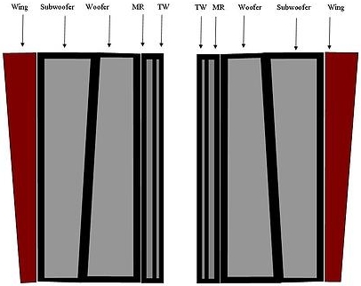

1) Pure physics means a more powerful magnet field means less amp power is required. This is an undeniable fact. Neodymium magnets are a lot more powerful that the quite weak ferrites used in standard Apogees. I believe the ones used by Apogee are slightly below C9 strength. Neodymium's have 3 or more times the field strength.
2) Follow this link. Definitive and 17 Watts. That's six channels of 17 Watt amps driving the Definitive. I tried a 50 Watt Graaf 50/50 on my Duettas and all you could get, at anything approaching a normal listening level, were farting noises of an amp driven into clipping.
3) If they wouldn't drive the Definitives to a reasonable level, why would he be inviting people around? He isn't saying they were killer, just that they would make some pretty good noises.
4) Is 100K dollars expensive? That's about £60K here - the same as an ML Neolith. Imagine the neo magnet arrays in there. I'd estimate about £10K's worth TBH. Plus the price of the Corian, the machining of said material, the expertise, the one off price of machining the metal holding the bass driver array (massive quite thick perforated metal sheet) and a lot more besides e.g. one off ribbons.
5) Make a pair for less, David. You wouldn't be capable of it. You almost certainly couldn't do it. You don't have the required knowledge or experience. Nor do I. The point is the price of expertise and the long hours put into these must have been seriously formidable. Free to Graz of course.
6) Improves focus like you said? No - it does a lot more as I said. Focus is not a generic enough term to cover the list of subjective improvements proper bracing provides.
7) Well done for fessing up you were wrong about Definitive being described as a non-dipole.

Generally, neodymium implementations are not available in the new speakers, I believe. C9's will be in Advance 7. Synergy is no more. However, a phone call will probably get anyone what they would like if they are serious enough to take the risk and provide a deposit, I suspect.
