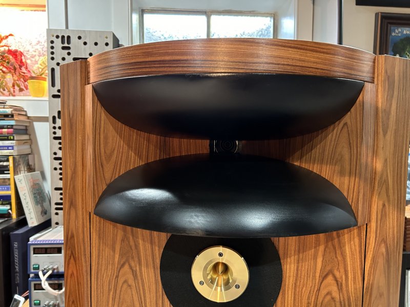

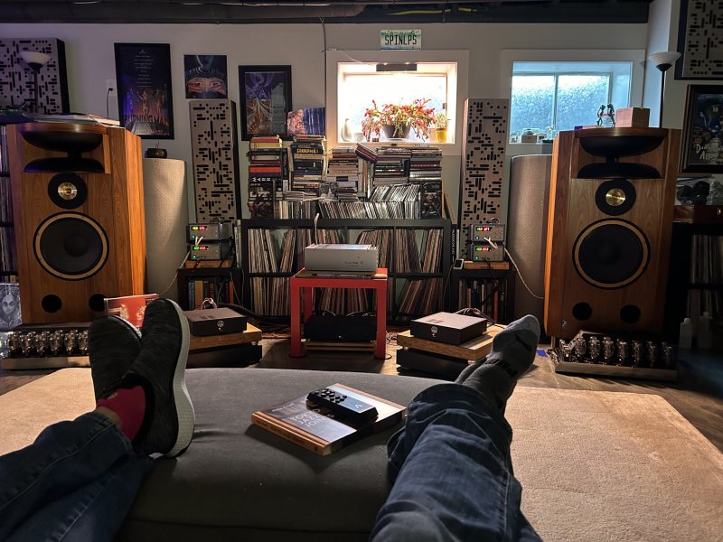

Nice system

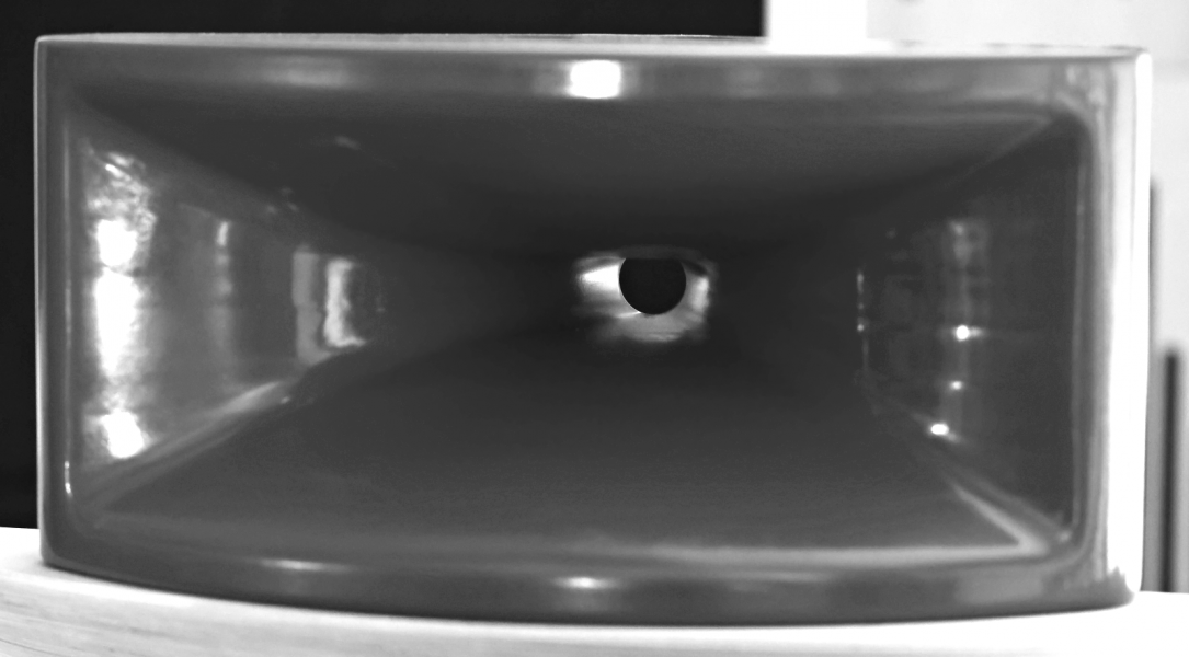

Would it be too much to ask to take a close-up photo of the radial (mid-range) horn?
I'm curious about the throat section.
Yes, here you go. I’m curious, what are you looking for?
Reactions: D.Duttilleux
Thanks for the picture.
It's the transition from the driver's exit to the (horn) throat that interests me. The transition is potentially a source of diffraction and therefore distortion.
This is a similar (prototype) horn with a smooth transition (without sharp edges):1698526059247.png
This is a similar (prototype) horn with a smooth transition (without sharp edges):View attachment 118946
I believe John Wolff worked with Edgarhorn on this T3 midrange design.
