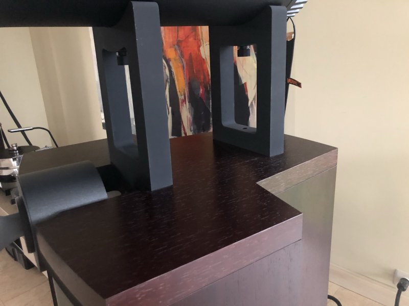

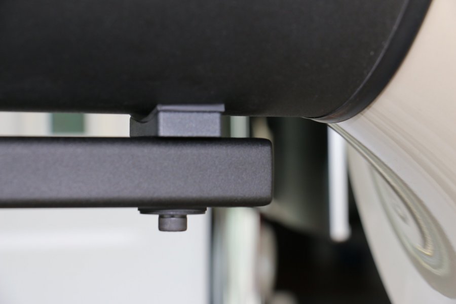

Not necessarily. With my mods to my early Duos substituting an F Frame with the original 3 upright tubes, the tubes are bolted to the frame but there's no metal-to-metal contact. The holes for the bolts are over-sized with a neoprene tube separating the bolt from the frame, there's a pad of Sorbothane between the frame and the horn tube and finally there's a neoprene washer under the head of the bolt. You can see some of this in this photo. No hard contact.
Note also that the F Frame is also isolated from the sub enclosure by re-using the rubber bobbins that AG used to fix the uprights to the sub. They may look solid but give them a squeeze. There's no solid contact between the sub and the uprights in original AG design and the same applies to my F Frame. Why AG has now moved to solid metel-to-metal connections with the Duo XD I'm not sure, I'll be modifying my XDs soon. Peter
