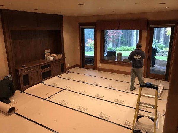

And so it begins... with the room cleaned out, the contractors have started this morning protecting the floors for the demolition to come.

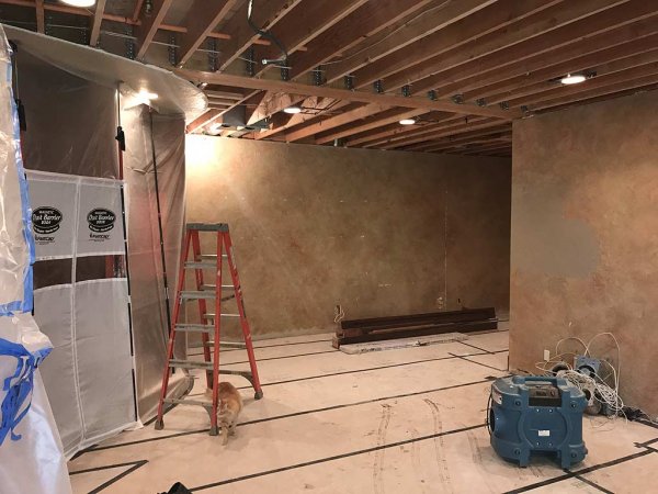

Funky, wierd, what's-that-for" cabinet removed exposing where the wine cellar will go, and dust-contain setup.
You can see on the floor in front of the dust-curtain marks showing roughly the arc of the curtains that will ultimately run across the base of the stairs.
