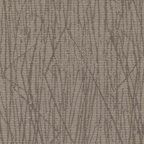

It looks great! What kind of fabric-wall are you using?
The fabric wall will use trac from "fabric-wall.com" and the fabric is Guilford "reeds" in "mink" color. (a nice match for the 'topaz' color of my Alexias) It will go on the walls in the recessed niches (alcoves?) on the left and right walls, and on the wall in the back of the room. It will also go on the suspended panel that will cover the obsolete whole-house audio stack on the right wall.
