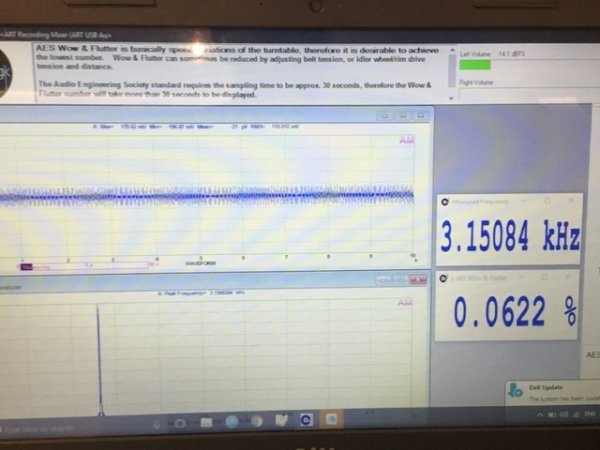

hi, the BB is using a four phase motor with 500 grams flywheel. considering that there is no Speed feedback and auto speed correction the speed is very stable (see video Below )
I wanted very much to use the BLDC Rim drive but it’s incompatible with the height of BB. I have searched the option to have a BLDC pod fabricated to match the Balance’s belt groove and again it’s very difficult.
Check the Balance’s speed stability here:
the Balance’s speed stability is reflected through the AM wow/flutter measurements i made, which are really low for a belt tt:
Pretty darn good. I would imagine you could get it even better with a feedback loop if you can get the Eagle/Condor/RR to work with the Brinkman. Should be able to get it to approach the Technics 1200's wow & flutter of +/- 0.035% peak, although that is measured under IEC 98A weighted, while AnalogMagik measures under AES 6-2008.
The designer of Balance, Helmut Brinkmann, doesn't like the closed loop idea. The speed as you see is very stable, in an all analogue configuration.
