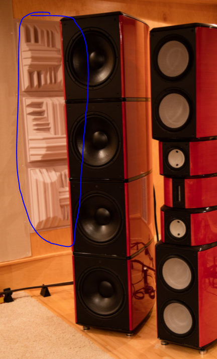

coupling and decoupling a speaker and room, in my mind relates more to volume of air moved, and the size and degree of sealing of the room. you want the low frequencies to be able to 'hook up' and allow the bass and musical energy to be physical. typically this does not involve surface diffusion. more mass and large trapping implements....and then matching the room with the energy of the speaker.
OTOH; i do have a speaker<->wall interaction in my room, which "could" be termed coupling/decoupling that is influenced by diffusion. my bass towers are massive; 7 foot tall, 750 pounds, and 35 inches long. they are near the side wall on each side. as i was tuning my room and experimenting 5 years ago now, i discovered that there was a distortion coming from that interaction of musical energy reflecting back and forth between the wall and side cabinet. i experimented with various solutions, and came upon adding three Aural T-Fusor diffusors on the wall opposite each bass tower. my room naturally retains a lot of musical energy, and i do tend to push things.
problem solved.
you might also note the cloth next to the T-Fusors; that cloth tames the side reflection from the opposite passive tower, since the bass towers block the near speaker<-> wall reflections.
problem solved.
Sorry Mike I'm unclear if you would use the term coupling with the room when discussing speaker placement?
Is bass frequency hookup is this where you'd think of a room/speaker coupling? What if when the low frequencies travel through the walls to other spaces, same effect but no containment?

sorry; i'm dropping into the middle of your conversation so maybe my post is not relevant to your point.
and yes; as my post mentions, 'coupling' to me in terms of speaker/room is mostly degrees of speaker energy/room size/build matching. i use the term 'hook up' to describe what i'm looking for.
sure; speaker placement can affect coupling. as height off the floor, proximity to walls, the structural make-up of walls, all contribute to speaker/room coupling. and a few other things likely too.
as far as traveling through walls; you have to consider what it takes to establish room boundaries to focus the bass. in my case; 6 years after i built my room, i added a layer of Quietrock 545, plus a layer of 3/4" finish grade plywood on the front half of my room to attain a good leverage for effective bass hookup. i think it works well. the bass is physical and the room is lively.
