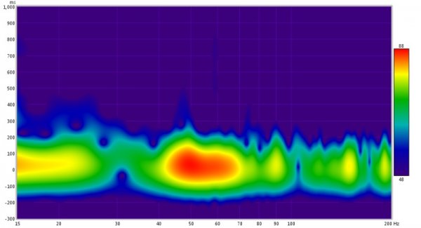

Rutgar and Microstrip...not sure if you have read this but very pertinent to this conversation. Jeff mentioned it earlier in the thread...the acoustical measurement standards, the white paper Jeff and I co-authored. In the low frequencies (<250Hz) don't look at T60, look at FR and a time domain measure like a spectrogram, waterfall or spectral decay plot.
FR: Within +/-10dB at 1/24th octave, Within +/-5dB at 1/3rd octave. Note that this can be tightened to +/-2.5dB with VERY careful acoustic design and calibration but +/-5dB is the minimum. Also please note that 1/24th is good to pinpoint issues but 1/6th or 1/12th is about the limit to our perception of timbral distortions so often I'm using those levels of smoothing now.
Time decay: Resonances from 35Hz-300Hz should not extend beyond 350ms before decaying into the noise floor or reaching a level of -40dB. Below 35Hz this standard is relaxed to 450ms.

LOL! I was asking you. But, if I was to guess (using my lack of expertise), I think it looks like I'm doing fairly well in the time domain. But have a couple of nodal issues in the response realm.
Yep, that's pretty much it :)
I would look at the ~50Hz region which requires some further attention. But likely you can already see that quite clearly on the frequency response.
Yeah, that area is looking quite nasty. I also understand that region can be very difficult to tame with room treatments.
With that area you are right. I would start with speaker / listener position. If you are using subs then you can place those. Try and get things as flat as possible. Then the next place to look would be parametric EQ, especially if you have only one seat that you really care about. If you have multiples then you'll need multiple subs in specific mode canceling arrangements and maybe some EQ. Finally I'd look at acoustic treatment. About the only commercial thing that works properly down that low is RPG Modex Plates. You can build custom stuff that is very effective down that low too. Some other products have some absorption down at 50Hz but they are tapering off in effectiveness pretty fast.

BTW, thanks for you help in this thread - I will take a few fresh measurements this weekend and post them. My main concern now is the too long decay at 18 and 35 Hz.
Yep, the metal plate absorbers. Please reference the reduced targets for decay time at the lower frequencies. Also note the <25HZ long decay times are not typically modally related.
But in this case my room is 9.3m long, exactly half of the wavelength of the lower frequency with the long delay. And the frequency of the second one is just the double. It looks too precise to be a coincidence.
