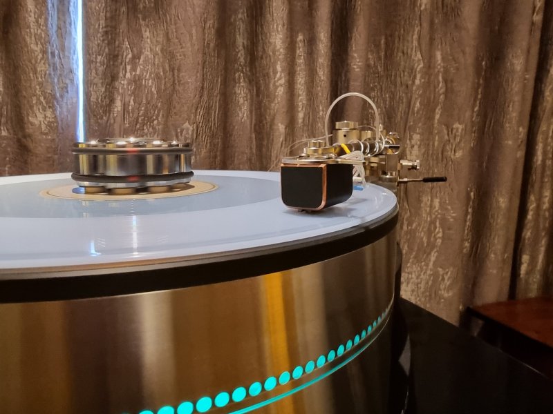

I heard the much hyped Dava ref cartridge today at the Manila hifi show.
Hard to comment really on such an unfamiliar system
Didn't make me want to rush out and get one thou
I had the same feeling after hearing it in Warsaw a few weeks ago. Though lacking sound quality in a show of course does not mean the product cannot perform excellent in another setting.
