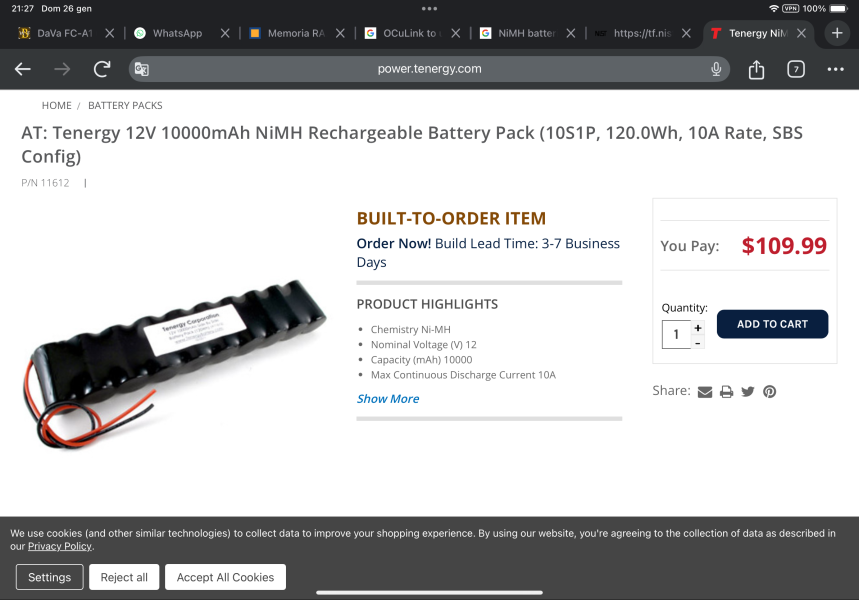

Hi guys, although I will build the tube power supply because the magic light of the tubes creates a strong visual addiction for me, I found this battery pack on the web that would guarantee me at least eighty hours of good listening, but if I wanted to be able to vary the current from 10.5 volts to 12 volts how could I do it, could I use resistors?IMG_0214.pngIMG_0215.png
When you have found the optimal voltage, determine the resistance value and use a good 2 watt resistor e.g. Vishay then support the voltage with cap 47uf nichicon supertrough. Its a better solution.
if the coil needs about 100mA and you want to drop about 2V that equates to about 0.2 watts. While a 2W resistor will certainly work, it does not need to be that big. Half watt is plenty big.
The output impedance of the power supply (internal resistance of the battery + resistance of the wires) plays a role in how it sounds and this resistor will increase it by a huge factor. To drop it from 12V down to 10V will take about a 20Ω resistor. Assuming the battery has an internal resistance of 0.1Ω (it varies) then you just increased it 200 times with your 20Ω resistor. Following that with a cap will decrease it again, but the cap also has a sonic character, and the Zout will still be higher than without. One way to reduce that factor is to use an active voltage regulator, but again that will (may?) sound different.
All that said, there is no way to predict how it will affect the sound and more importantly, which you would prefer. Like most things in this hobby, you will have to try it.
