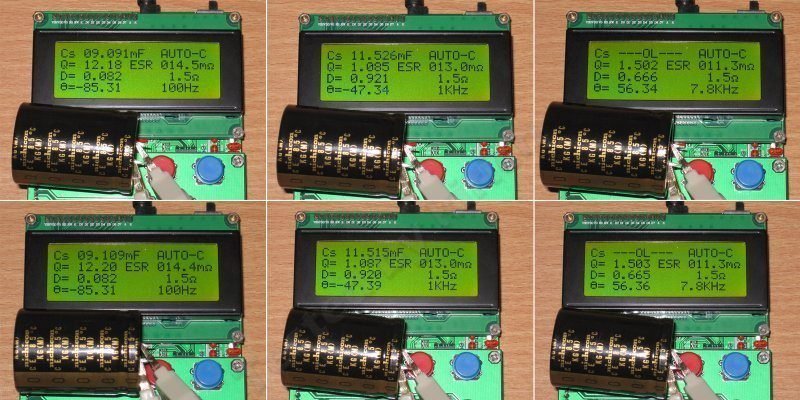

However, your claim that an electrolytic cap has "almost no sound signature" is highly debatable, and at this level, even "almost" can be significant. Curious what the ESR is as I can't find it? How much lower than a high quality battery?

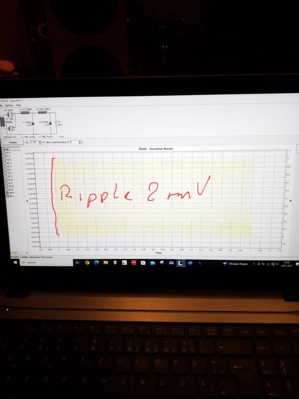

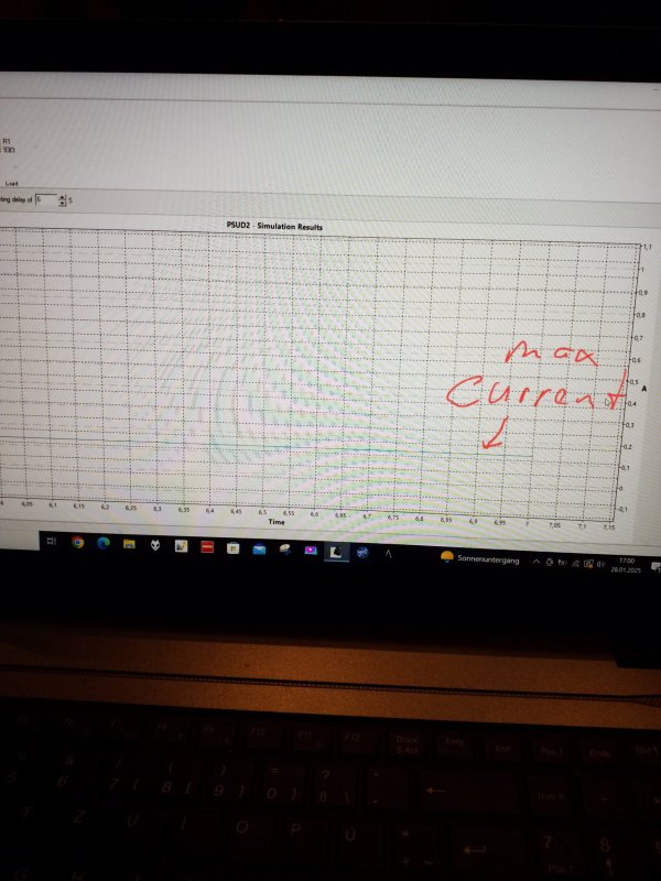

I simulate for fun a full wave bridge ez81 tube power supply
Main transformer secondary 120volt 0.3A winding
Caps need only 63 volt type
Coil resistance 93 ohm cartridge 12v÷.0.13A
Ripple output 2mV voltage output 12.5 Volt
Heater winding 6.3Volt 2.0 Ampere
Zoom in shematics
Current line
