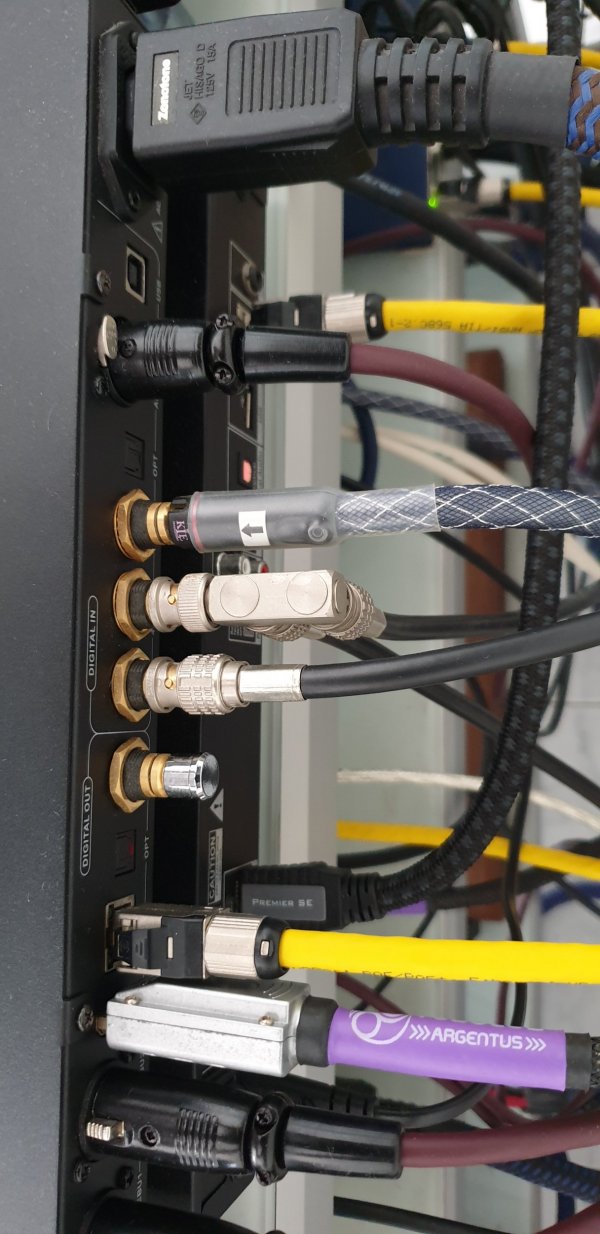

To be clear on one point in my previous post, for RJ45, I am only referring to an RJ45 cable inserted between the Denafrips DDC and the Denafrips DAC. For RJ45 cables placed elsewhere in the system, the length is not an issue.
Hi Blake,
Noted and will try using available 0.5m and 1m yellow cat 8 ethernet from Hermes to TP via i2s-C lvdcmos to try against dual aes-ebu to report back any pop and difference in sound quality then.
But as mentioned, I am using only ddc for non dsd source of bel canto fm tuner with Antipodes direct to TP via usb and do not expect better sound quality with only available i2s-C when back to 96khz like hdmi i2s vs dual AES at 192khz.
Cheers.
Richard

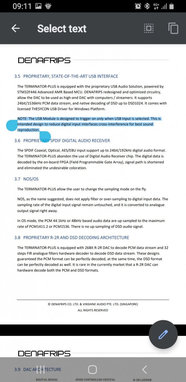

I was reading the TP manual and it says the 5v is needed to trigger the USB input on, apparently the USB is turned off if it is not used to lower noise.Hi Rikki,
For whatever usb cable into TP, try the very affordable idefender3.0 to cut 5v ... TP work without 5v this way.
I have no doubt cables makes a different beyond a certain level, it is to "tune" our system to circumvent some limitation present and to your preference.
For i2s, I prefers RJ45 into TP in my system and not hdmi and for non dsd, you can also try dual AES-ebu from denafrips ddc to TP.

Hi Rikki,I was reading the TP manual and it says the 5v is needed to trigger the USB input on, apparently the USB is turned off if it is not used to lower noise.
I remember I had early issues when I ran several servers with one that had I2S out, if I changed input between USB and I2S and then back to USB I would need to restart my USB server to retrigger the USB to turn on after leaving it. I wonder if I need the 5v trigger now with the Iris.
Hi Rikki,Hi Richard, I got this from the denafrips FAQ page under USB
DENAFRIPS DAC USB module is powered by its internal regulated, low noise, low ripple, high speed linear power supply.
However, it needs the USB cable to supply the +5vdc as a logic signal to trigger the internal power supply to the USB module. This design is intentional for best sound quality consideration.
I use the I2S input now. I do have a USB cable between the Statement and Iris, I don't know if the Iris needs a 5v signal.
