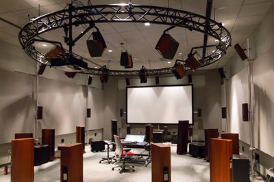

As you know audio technologies from DTS Inc.(NASDAQ: DTSI) are used in a wide range of consumer electronics product applications as DTS provides a suite of audio processing technologies for users of consumer electronics products.
DTS also provides products and services to motion picture studios, radio and television broadcasters, game developers and other content creators to support the inclusion of DTS-encoded soundtracks in their content.
DTS, Inc. recently installed a 32 channel Dirac Live Room Correction system in the mixing studios at their headquarters in Calabasas, California... this is what Zoran Fejzo, Head of R&D, Fred Maher, Mastering and Mixing Specialist and Bob DeMaa, Audio Testing & Mixing/Mastering Specialist, said:
"We all sat down and listened to Dirac Live. It's remarkable how much of difference it makes for some mixes and is really revealing about the room the material was actually mixed in. No other room correction system that we have tried really touches the precision we are hearing with Dirac"
The possibility of making that special 32 channel version of Dirac Live a commercial product for studios is under evaluation.
