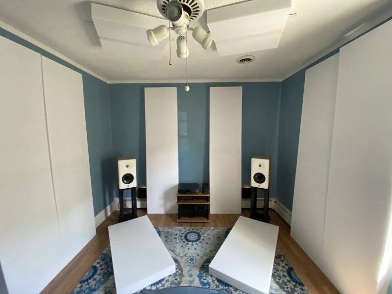

I've been experimenting a lot lately with different amounts and configurations of my 4-inch-thick acoustic foam. Over time I began to think that perhaps the room was a little too "dead" sounding although the imaging and staging was quite remarkable. I was using a total of 19 2' x 4' batts of the foam, or 152 square feet of it in my 11' x 13.5' x 8.5' room. I had five batts deployed behind and between the speakers, six batts on each of the side walls, and two batts on the floor, one in front of each speaker.
During these experiments I changed nothing about the system or its set up other than the amount and placement of the acoustic foam. I removed all the foam to get a baseline on the sound of the speakers in a reflective room. Not bad at all. As I've said before, the D&D 8c's sound much better in this small reflective room without much room treatment (I'm still using my P. I. Audio Group diffusers on the wall behind the listening seat). Nothing obnoxious at all and a very "live" sound. Imaging and staging are quite nice. I could imagine that many listeners would find nothing at all amiss with the sans-foam sound and might even prefer the "liveness" of the sound.
With this sort of "live" room, the volume does not have to be turned up so high to get the feeling of adequate SPL. The bass is very solid and punchy and the room "lights up" with sound.
However, on classical music with lots of complexity (e.g., the finale to Beethoven's 9th Symphony on RR Fresh) I could hear a bit of compromise in stage depth and image placement/stability. This was probably subtle enough that most people would not notice if they were not familiar with the sound of such pieces with the acoustic foam in place.
Also, there is a subtle "crunch" or "cringe" factor in large scale dynamics at high SPLs. The emphasis is on "subtle" here, though. Such effects have been much more obvious and obnoxious in this room with other speakers when acoustic foam is lacking. I speculate that the combination of the D&D's rather controlled dispersion and the evenness of the off axis response reduces the audibility of such effects and greatly reduces their obnoxiousness.
Again, with the D&D speakers, those not familiar with the acoustic effects of acoustic foam may well not realize that this "crunch"/"cringe" is even there until it is gone. But this is something you never hear from live unamplified music in a decent indoor concert venue no matter how complex or loud things get. Live, the music just gets louder and large scale dynamic shifts are just thrilling with no "cringe" factor at all.
I then began to add back the acoustic foam batts listening for changes with each iteration, also experimenting with their positioning. My goal was to eliminate any "crunch"/"cringe" while improving the "liveness" of the room. To make a long story short, I have now come upon what seems to be an ideal solution. This involved removing the four batts of foam on the side walls nearest the room corners behind the speaker. This removed 32 square feet of foam from the room, leaving 120 square feet.
In the course of this experimentation, I also discovered that, as with the diffusers I formerly used near the speakers, at least in this room the sound of the D&D speakers is sensitive to placement of the foam too close to the vents on the left and right sides of the speakers. A few inches of space is all that's needed. This few inches probably is needed because of the cardioid design of the 100 - 1200 Hz range reproduced by the mid-woofer on the front panel. The sound from this mid-woofer needs to wrap around the cabinet to produce the cancellation of sound radiated to the rear and maintain the intended polar pattern of the speaker. If the foam is positioned too close, the frequency response becomes subtly colored, depth of imaging and expansiveness of the stage in all directions is impaired, and the low end loses some of its magic combination of punch, definition, weight, and extension.
In addition to a bit more "live" feel to the room, the sound now is even better than it was with the additional foam. The bass is even more rightly spectacular, the spatial presentation is even larger, depth of field and width of stage are expanded, and there is a greater sense of envelopment. It continues to amaze me that such sound can be produced from two smallish-looking (from the listening position) speakers!
The new look of the room is similar to the prior one, but here's a few shots of the new foam arrangement.

I think I have finally figured out a way to put absorbing foam on my popcorn ceiling without doing damage to it. It seems to be holding; we'll see if it stays up.
It is a definite sonic improvement when combined with removing the foam that was centered on the wall between and behind the two speakers. Basically I put two 2' x 2' sections of foam on the ceiling in the first reflection areas and removed the 2' x 4' batt of foam I had at the center of the wall behind the speakers which was not really in any first reflection area. This change significantly improves the three-dimensionality of the presentation and further increases its apparent size while leaving the liveness of the room at about the same level as it was before since the total amount of foam placed against the room surfaces is the same as before.
First I determined the first-reflection areas on the ceiling by trial and error using my 4" x 6" flat mirror mounted flat agains the ceiling temporarily with masking tape. Once I could see the front of each speaker in the mirror when I was sitting in the listening position I used blue painter's tape to mark the outline of the mirror. Then, after removing the mirror, I put a small piece of blue painter's tape in the center of the mirror outline. I then measured one foot in four directions from that centered piece of tape and put additional pieces of tape on the ceiling at those points. That gave me the outline of the area where I needed to mount a 2' x 2' piece of foam on the ceiling.
I then cut one of my 2' x 4' batts of foam into two 2' x 2' pieces with my Cuisinart electric kitchen knife. The foam cut like butter with that knife. Then I wrapped a continuous strip of two-inch-wide white duct tape around the center of each white piece of foam so that the tape overlapped a bit after encircling the foam and could thus attach to itself for a few inches. That will prevent the tape from coming unstuck from the foam.
Then I mounted two 4" x 2" pieces of heavy duty outdoor velcro meant for rough stone or concrete surfaces to the ceiling and made sure that it was stuck as tightly as I could get it to the popcorn ceiling. I left the protective coating on the velcro which would attach to the foam as I pressed the velcro into the ceiling. Then I removed the protective coating. I then carefully placed the foam against the sticky side of the velcro so that the duct tape wrap made contact with the sticky velcro. The duct tape, unlike the foam, should stick well to the velcro. That's the plan at least. I have high hopes that it will stay on the ceiling and not fall down.
P.S.: They did not fall down, but I did add additional support by attaching an additional 2" x 4" piece of this same velcro to the ceiling just touching the outside edges of the foam where the tape wraps around. I then anchored additional duct tape to the exposed sticky side of the mated velcro pads and ran this tape along the existing tape going around the foam batt. The foam is thus now held to the ceiling both by velcro attached to the ceiling under the foam and velcro attached to the ceiling just outside the edges of the foam. The foam is not going anywhere now.

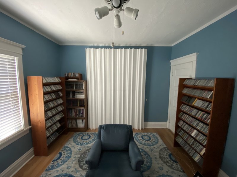

Here are a couple of wide-angle pictures of my current D&D 8c set up showing the deployment of four-inch-thick Alphasorb absorbing acoustic foam at the first-reflection areas on the floor, ceiling, wall behind the speakers, and side walls, as well as the diffusive treatment of the listening end of the room.
