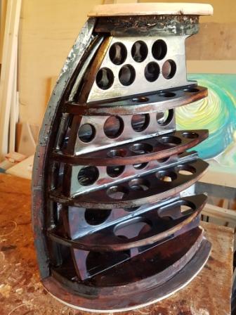

?nother small step in my project;

An interesting situation, nobody asked me what happened to the column volume in such ventilation! How will we calculate the volume/ have st losses/ in this complex form of ventilation?
I am an electric engineer,assuming I use a program (CAD ),entering data into this complex, incorrect form would take me a very long time, effort which for single production makes no sense..
The making every detail is unique, It is normal to have differences between them.
When assembling the structure, i do extra work in the interior of column, which changes volume.
It's clear that the software will not help me,mathematics - as well.
I'm trying to get closer to her alternative - the egg, so I solve the problem /as possible/with Fb ,Fc. My project is at an early stage and do not have , will not matter unless I get the right volume.
I want this to use as a hint!

I want to show how I find the volume of a complex, constructive body:
At the third photo, the red line is the waterline,must be fill with water next to it / everything must be perfectly horizontally!/.
-I measure the weight of the my vented inner construction - 3.5 kg.
-The amount of water is 42 l. in the box; 42-3,5= 38,5l, 4.5 l more than what's needed - what's next?
I know the total volume, now everything is very simple there are several options for correction;
- purely mathematical / small planarity, simple algebra and axonometry /
- methodically- it can be done in several ways.

I continue with the collection of the cabinet;
Now I can make the exact measurement of the volume. And that's 31.5l, just as much as I need!
Oh, l forget to show you what I did to get that volume!
I maked a filter compartment (for the MW and TW), the W section will be in the box;
