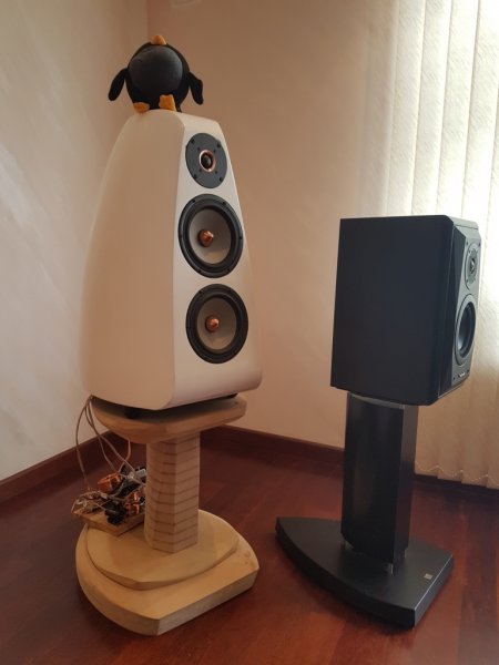

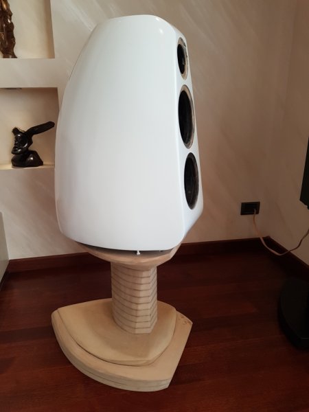

And a risky picture (everything is supported by gravity), how look for compared to the front speakers, are not on one line, but I rely on your imagination.

The first home tests are good.
My current surround speakers of " Technics" CA-10 with a good sound from 1997, they are sadly retreated himself ...
Reactions: Protegimus

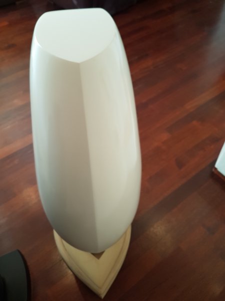

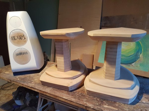

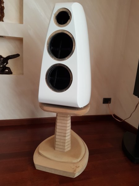

Sounds like they could be mains.
A very underestimated moment - work with multilayer MDF!
There's still a lot of work on the stands.
I show you a few pictures of the front speaker bases, the rear speaker stands will look like the same;Always been a problem with the MDF, especially when we have a multilayer construction. Over time, individual parts are beginning to show up - all of this is the result of improper processing. Soon I will show you how to deal with this problem.

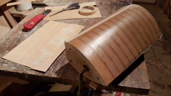

These days I remembered that I did not discuss my veneering technique with natural veneer for cabinets with a polyurethane varnish base. Like this pozicion-1
how i maked and finish in pozicion- 2?
Thank you !
I don't know to exist 3D veneer - I'm kidding!
Showcase your work, if you wish, I can give you useful information.

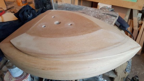

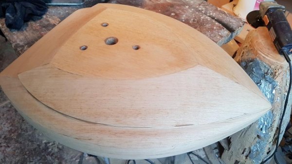

Not everything is as easy as it seems, the problem with the seasonal movement of MDF material is not to be underestimated! Typically, problems with the multi-layered construction of MDF details occur after several seasons, I'll show you how I handle this task: 6.jpg
On the first photo, we can see the hidden problem that will appear in a few years is very well.
I show my way of dealing with this task;
