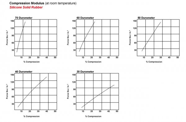

Looking at the data below, intuitively, it seems ineffective to use a middle silicone damping layer which covers the entire surface area of the top and bottom layers. Back to US units, if we build an 18"x12" (216 in2) platform, and assume 50 lbs of granite and 60 lbs from a component or moderately sized TT on top, then we're only applying approx 0.5 lbs/in2 and getting near zero compression of the silicone sheet. If we were to target 20-30% compression, then we'd want to calculate appropriate surface area and cut down the silicone sheet into appropriately sized strips place around perimeter, or square pads placed in the corners, etc. The entire surface area of the top and bottom layer no longer make contact, but I can't think of a reason now that they must. Thoughts?
