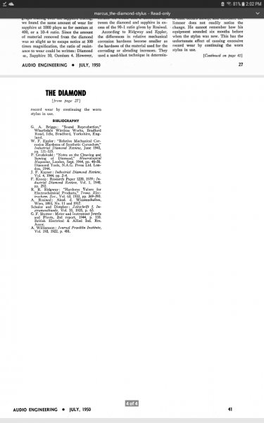

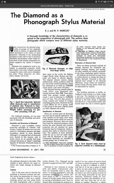

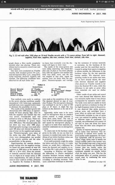

* I'm trying to get a pdf link, a very cool one, if I cannot I'll post the attached files...I need few more minutes ...
