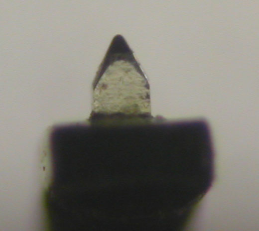

Some tools of the trade ...
It’s interesting the cleaned ones tip is black, could just be shadowing ?
I was wondering could a ultrasonic stylus cleaner damage the stylus mount or the suspension of the cantilever
I too thought it was the light's angle creating the shadow, but from searching further it wasn't.
Some stylus are completely transparent, others are black, some have a different material termination. ...We have diamonds, sapphires, etc.
