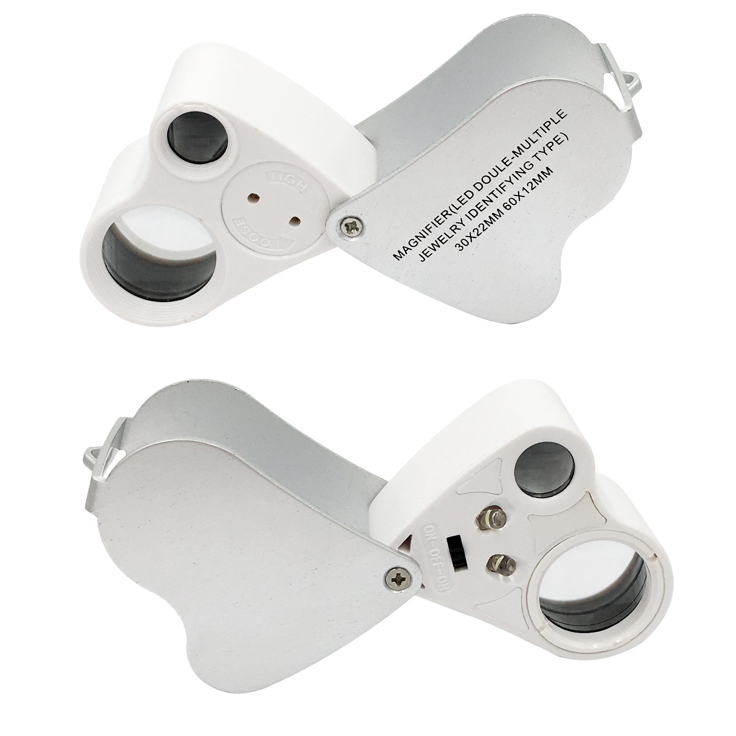

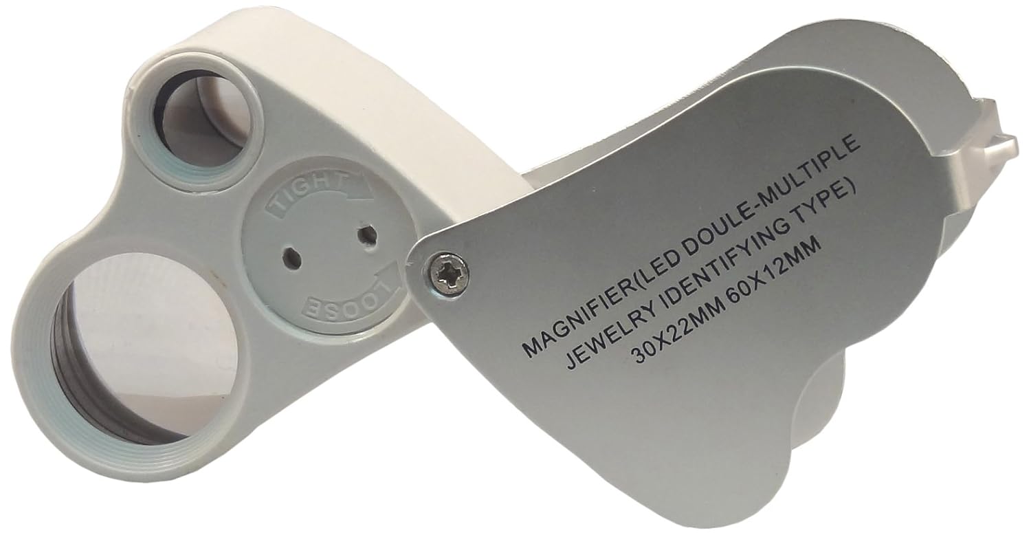

Bob, thanks for posting all of the photos of the various loops and magnifying devices. Only concern i would have with them is that one has to be very very careful when using them and focusing on the stylus- to not bump or touch the cartridge. Bumping the cantilever with the loop could be very damaging to the cantilever. The focal length is therefore questionable with these devices when looking at the cantilever/stylus--made more difficult based on the particular design of the cartridge and cantilever assembly. Therefore, this would lead me to shy away from using these devices due to potential risk of damage. One mistake and it could be costly!
Don't toss your brush. An important part of the ME protocol is to gently brush the stylus after using the ME because it can leave small amounts of ME residue on the stylus. PeterA uses the Onzow for that purpose; I like a 00 artist brush. The residue looks like very tiny white flakes. That happens probably less than 50% of the time but that residue should not go into the groove.
I guess I could use my SolidState for that. Good point.
Are you guys getting any closer to a definitive product and procedural recommendation?
Excellent question. It seems the answer is illusive, as it appears to be dependent on the comfort level with some of the products available. I am one of those that seem to be more risk adverse in regards to some of the products, like the ME. Others are seemingly more accepting of something like the ME...which there is nothing wrong with. I do question whether the results with using the ME ( or for that matter something like Onzow) are possibly detrimental...which most likely depends on the protocol that is used. Another question ---does anyone have knowledge of anyone who has damaged their cartridge using ME? ( With all due respect to Peter A, who I am sure has the art of applying ME down to a fine art).

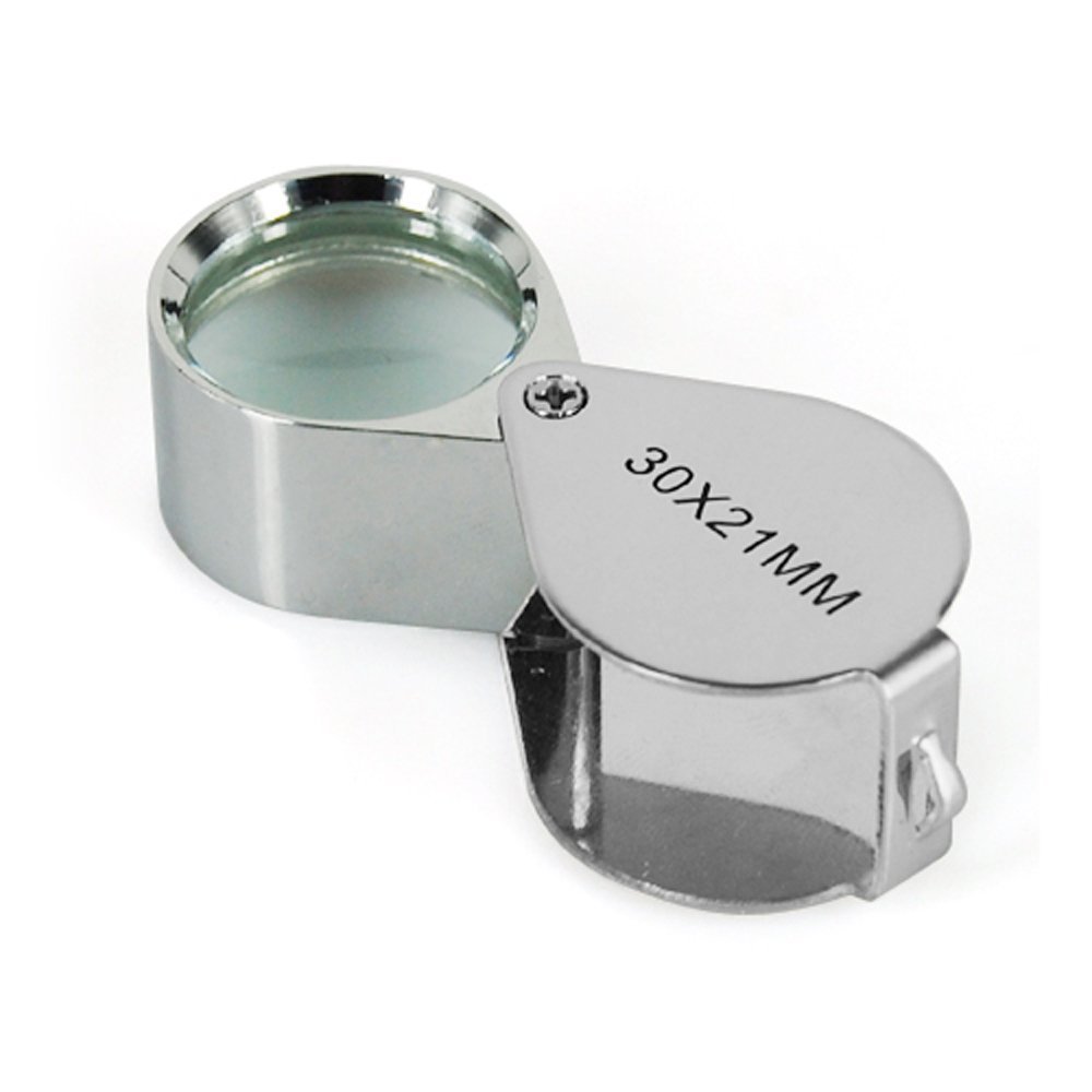

I have used the 30x jeweler magnifier for over twenty years without ever any incident.
I lock on my tonearm when I inspect. And with practice we get good and quick @ it, I do.
By the way, Tima mentioned 10x ... I recommend 20x @ minimum.
And when you have a brand new cart and stylus, or a stylus replacement; inspect it first with the magnifier, so that you have a reference of what it looks like when clean.
