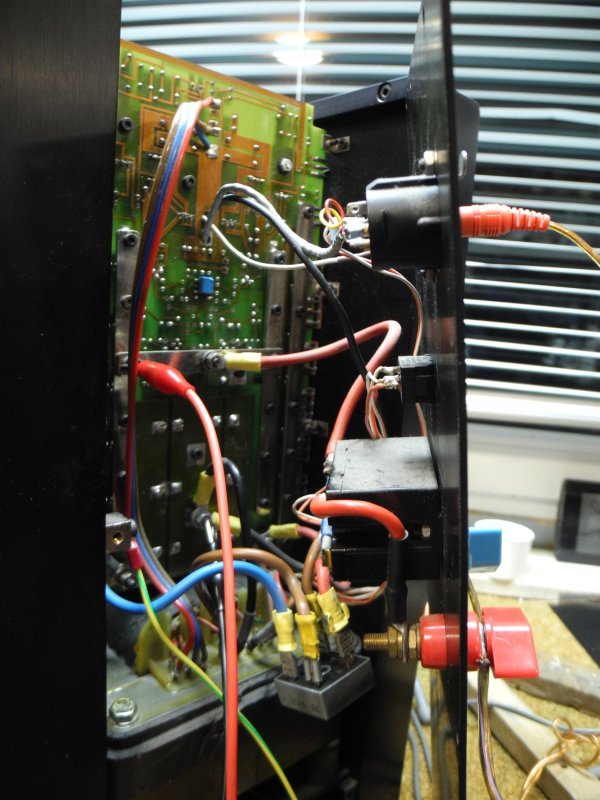

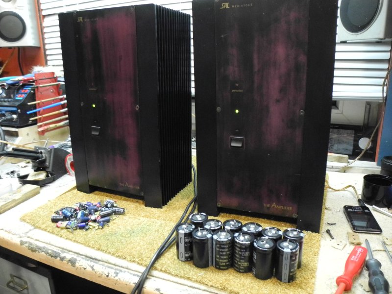

The power supply and capacitors are located in the bottom, it is not hot the 40 degrees. The housing have ventilation effect is like a chimney at the top, all the hot air comes out hot enough just to keep a cup of coffee warm over hours. The amplifiers are on slate bases. In the sun you can see how the metalhousing has discolored.67347c (1).jpgDSCN5284.jpg

I don't know at 1987 are 105°types already existed, some had esr over 100ohms i change all after 38 years. protection works fine at 0.44 ohms the relay switches off the output until then full class A power. sounds amazing good after refresh. with a high damping factor over 15000 in the bass normaly sounds this dry this amp not. Love this oven
