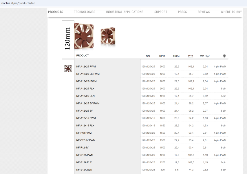

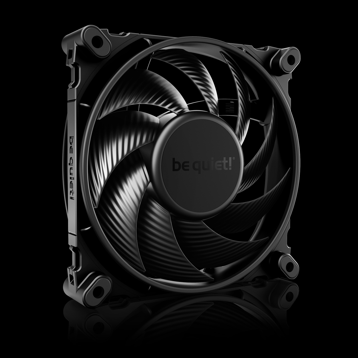

Thanks. Can you point a link to a 120mm Be Quiet model that is more silent than the equivalent Noctua - e.g. https://noctua.at/en/products/fan/nf-a12x25-5v-pwm?
I think the Noctua still wins? Here is their list of 120mm some of which produce 107.5 m3h of airflow while only making 17.8db of noise? The besilent is 82.7 m3/h of airflow and 18.9db of noise. the super quiet bequiet that is 15.7db of noise only hits 65 m3/h of airflow.
The Silent Wing 4 has 50% increased static pressure. That means that the Noctua when anything but open air situated, suddenly flows less. Also type of sound matters too - the frequency characteristics can mean more.
A lot of these applications only need air, they don't necessarily need much.
When you build PCs and try different fans and enclosures, the quietest is not always what you think it will be. In fact a ton of "quiet" products are noisy.

I wonder whether these would be better? He said he has ordered and trialed at least a dozen fans before settling on the Noctuas.
