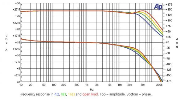

The first thing that caught my eye was this:
The frequency response wasn't bad, but the phase went from +20deg to zero in the frequency range (10Hz to 140Hz) that we were going to be using it in. Isn't that going to play havoc with the servo-feedback, I asked? "Well, we'll just slow down the servo so that it doesn't matter. Nobody's going to notice," I was told.
