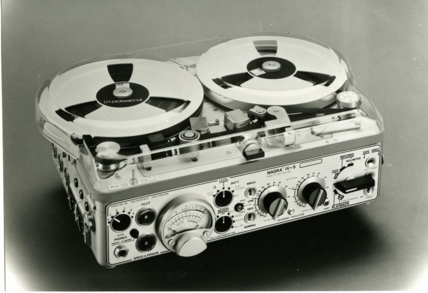

The Nagra IV-S was designed for location recording. It's recording quality is much better than its playback, which is really for monitoring purposes only, because there is no editing function on the machine. Both Jazz at the Pawnshop and Cantate Domino were recorded with a Nagra IV-S. All the Fone analog recordings were done with a Nagra as well. I have been using one for more than 20 years for concert hall recordings off a Studer mixer, and the result can be spectacular. No cassette tape recorder can ever hope to match it. If you want a machine mainly for making recordings, this is it. If you want it for playback, you can simply wire the playback head out and use an external preamp. The thing is rugged and indestructible, and spare parts are readily available because they were so widely used. All the TV stations, film studios and radio stations used them. Mine came from the BBC.
I think the Nagra IV-S may be more than what Rex is interested in paying. How much are they going for these days? Thanks, Larry
I do have a budget Larry. Not sure what it is. Maybe $4k???
Thank you Adrian. I think your noting what might work for me. Even a 7" tape would let me play my favorites over and over without worry. NAGARA wrote me back. All they said in broken English was 3 month wait. I wrote back and asked the price. We shall see.

Yes, please get back to us about the price. I would be interested to find out. There should be many of these floating around, but it is a risk to buy from someone unknown. I sent mine back to Nagra for a major service about 5 years ago, with new heads and belts installed. I think they charged me less than 1000 CHF.
Before committing to that purchase, I would recommend trying it in action. You may or may not like its function, it is not everyone's cup of tea.
Personally... I love Nagras, I have several, but I would never have it as my main machine.
