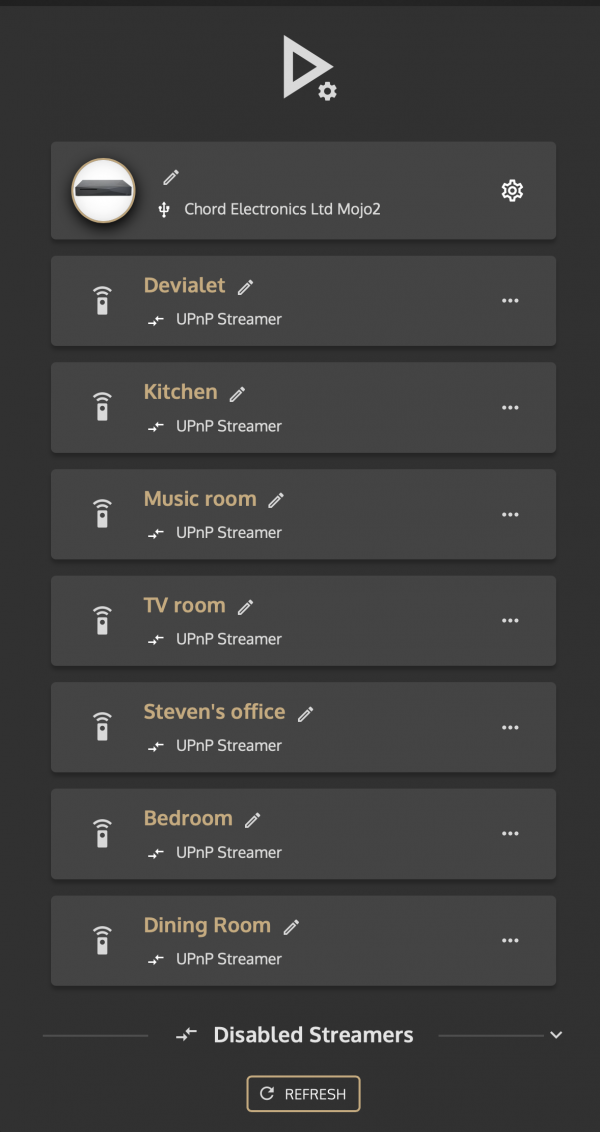

It has had uPnP built in for the last couple of years. It is used in Standalone mode with uPnP set to Sense mode.
It works fine, using the Sense player, and it shows up in the device's native app.
There are a few devices where you can use the device app, but it's limited.
This below is sending a DSD256 file to my 24/192PCM wireless ceiling speakers.
Frankly, Roon is better for doing this, given all my uPnP devices are also Roon Ready.
Screenshot 2023-10-26 at 12.36.56.pngScreenshot 2023-10-26 at 12.40.49.jpegScreenshot 2023-10-26 at 12.39.38.png

View attachment 118813View attachment 118817View attachment 118820

I think you are talking about Native uPnP integration. As stated above, that only works with a few devices as they require Innuos to create a device profile.
I tried it using the Lumin app. It sees the Pulsar, but no sound came out!
The use shown above is called Sense uPnP Integration.
