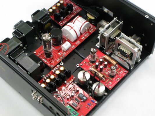

One of the most frequently asked questions I get as a Taiko dealer when I discuss the Olympus XDMI is:
"How can that little DAC card play at the level of the big DACs?"
To address this, I will use a photo of the Audio Note Kits DAC 5.1. It's a tube DAC that I have built and owned 6-7 years ago.
(these are stock photos from their website as I was too lazy to find mine)
At a very high level, we have three main sections in a DAC like this one - power supply, analog section, and digital section.
Power Supply:
There are many power supply designs. They can be switching mode or linear, regulated or unregulated, one rail or multiple rails. For a regulated linear design, you generally have a transformer, rectifier, filtering capacitors, and regulators. You may have multiple rails, multiple transformers, chokes, etc. Rectifiers can be vacuum tube rectifiers, diode-based, FET based, GaN-FET based, etc. I can't really list all of the variations and that's not the purpose of this post.
The ANK5.1 power supply has transformers, rectifiers (vacuum tube rectifier on the B+ and diodes on the rest), chokes, capacitors, and regulators.
I have highlighted the power supply on the ANK 5.1 DAC below:
Analog Section:
I'm not going into too many details here either as there are many ways you can design an analog section.
In the case of the ANK DAC, there are I/V transformers, a tube section, and output transformers.
I have highlighted the analog section on the ANK 5.1 DAC below:
Digital Section:
The digital section in this particular DAC (and many chip-based DACs) is very simple.
The green board on top is a USB to I2S converter. The converted signal goes to the bottom red PCB.
I have highlighted the digital section on the ANK 5.1 DAC below:
So the entire digital section is that little red board there. Let's zoom more into that digital board (okay, I had to dig out photos from my own build for this):
About two-thirds of the circuitry you see on the top is for the relay switching between S/PDIF and USB, powering those relay switches, and converting the S/PDIF to I2S. Only a very small portion of the circuitry around the AD1865NK chip has anything to do with the digital to analog conversion. BTW, this DAC weighs 30 lbs, and as you can see only a few small components around the DAC chip are responsible for the D to A conversion. I hope this clearly illustrates how simple the Digital to Analog conversion with a DAC chip can be.
Power Supply:
Analog Section:
Digital Section:

I posted a picture of the interior of my dCS Vivaldi APEX DAC a while ago:
Circled in yellow is the real estate devoted to the analog output stage. A couple of square inches at most.
Like Vassil, I don't need or want my DAC to be the vehicle for "tube goodness" -- I can accomplish that with my tube preamps or tube amplifiers, apologies to Lampizator owners. As long as it is neutral and transparent and to paraphrase the late Steve Jobs, insanely great, I'll be happy.
