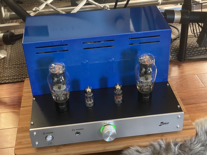

Candy apple red or electric blue metal flake to match one of my amplifiers would be very cool:
