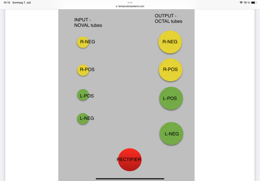

I am a very happy owner of the Poseidon DAC for several months now. I don’t post often on WBF, but I love reading these threads so thanks to all who do post. I’ve been upgrading my rig so maybe I’ll post more going forward.
My question is how can I figure out which tubes are used in which configuration? Does using Bypass mode effect which tubes are in use? Does it make a difference which output is used, meaning RCA versus XLR? I realize there is good information in the Poseidon user manual on the tube positioning (page 5), but unfortunately I am not technically inclined enough to know what it means. The manual does say, “It is possible and allowed to listen to one phase only if you use a single ended amplifier. Simply remove the tubes you don’t need.” This suggests that not all tubes are in use for every configuration.
The reason I ask is until today I been using the Poseidon in Bypass mode with another preamp. Then today I decided to try going directly into the amps using the Poseidon for volume control. I made the switch and suddenly I wasn’t getting sound from one speaker. After some troubleshooting I tracked down a bad EL6 tube which I had purchased on eBay and used with Laszlo’s EL6 -> 6j5/L63 tube adapters in place of the 6j5 tubes. To be clear the bad tube wasn’t from Laszlo but from a seller on eBay. Fortunately I bought 5 of them so I swapped in the spare and bingo sound from both speakers using Poseidon for volume control. I did switch from XLR outputs into my preamp to RCA outputs direct to my amp because I did not have a long enough XLR cable.
But I wonder why I wasn’t having any problem in bypass mode with the bad EL6 tube in? That suggests to me that the tube wasn’t utilized in bypass mode? Unless it just happened to fail when I made the switch. Any insight into clarifying which tubes are used for what purpose in the Poseidon would be appreciated.
Congrats to the Poseidon, nice gear. Looking at the manual on the Lampizator Homepage, it seems that the input and output tubes are even used in DAC only mode. Only the volume control is bypassed. I guess the malfunction in your setup as a pre is related to the fact, that you connected the Poseidon via XLR (balanced) to your amp, while you used rhe RCA outputs (unbalanced) in DAC mode to your pre. Is that true?
Hi thanks for your reply. Yes correct I had to switch from using XLR output to RCA output due to cable length limitations when I went from DAC only mode (I.e. Bypass) to DAC + preamp mode.
It seems counter intuitive though, I would have thought all output tubes are needed for XLR output, but perhaps not for RCA (single ended) output. It seems my “bad tube” was not being used in Bypass mode using XLR output, otherwise I would have noticed the problem with that configuration. But it was needed for RCA output in DAC + preamp mode, hence no sound from my speaker (until I replaced the bad tube).
The Poseidon manual includes the following schematic
and states „It is possible and allowed to listen to one phase only if you use single ended amplifierr. Simply remove the tubes you don’t need.“ So my guess would be, that in balanced mode (and if the following component is really balanced), all tubes have to work properly, in single ended mode only one tube pair per phase per channel.
