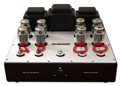

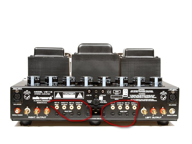

Here is an example of a manual biasing amp ,the ARC VS115 and VS110. Notice the top plate has holes for you to TRIM the adjustment. And the back panel has 8 pairs of pots to stick the voltmeter into, while you trim the value to .65mA.
I have owned these 2, and did the biasing myself, they gave me a long yellow plastic thin screwdriver to trim the bias on the top plate. There are no such things on the Jadis PA100.

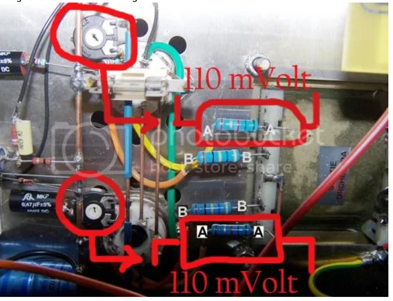

I'd like to see that , as you can see from the 3 pictures I posted of the inside of the under chassis, there is not pot at all. you need TWO pot per tube to manually bias them, PA100 has 12 tubes, at least you will be seeing 24 pots, there is none.
Here is it the link for that discussion relating to biasing of Orchestra integrated that includes replies from ex Jadis tech, some very itneresting info, however still not definitive, as I have been offered an ex demo PA 100, and need to make a decision now.
The mere thought of having to open a 125 pound amp, and poke inside it every time one of the 12 tubes fails , ( or not to mention having to lug it to the technician), just terrifies me , despite having owned VTL amps in the early 90s. The amp is physically huge, and I carrying 125 pound box is not as easy as it used to be 25 years ago :(

There is no need to bias. There is nowhere to do the biasing. There will always be a measuring pot and trimmer pot in amps with manual biasing. I have used CJ125, ARC D115 (1980s) VS110, VS115 and there were voltmeter pots and trimming pots in those amps. The PA100 has nothing. So I have just put in 2 brand new KT88s into the amp bec of failed tubes and I did not do anything other than put in the 2 new tubes to the socket It's been working for weeks now. I have written Jadis France many times and they give you a 1 sentence answer, if you're lucky, 2. :) I've even posted the bias question in Brook Berdan's youtube video on the PA100. No answer. I just chalk it up as a misprint of 'manual' biasing. All amps say 'automatic' except the JA 500 which says Manual, need to make adjustment for different kinds of power tubes, something like that.
Jadis have replied with 2 sentence email: Bias is Manual, and I can use EL 34 in it (although they don't say whether its just plain substitution, or what adjustments need to be made), but NOT the Kt150 tubes, and have given me the address of the distro in USA,, (who is in Canada) and pretty much useless, and does not answer any inquires rregarding their product, and force you to get in touh with your local dealer, who also NVER replies. Just not customer oriented folks, (or as some folks in NY would call "a chain of dicks") and do not inspire any confidence to spend lot of money on their product so I ll think I will pass :(, as much as I would like to get one. Not worth the trouble!
You just showed a Jadis Orchestra amp. I'm talking about a PA 100. My PA100 does not have that trimming pot which is shown in the Orchestra picture.
