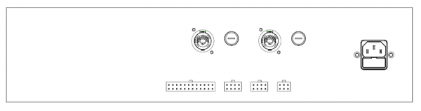

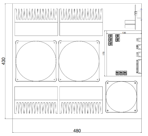

OPTIMO_ATX
SNEAK PEAK
In Jcat we work to develop and bring to you new exciting products. Here is a short sneak peak of what we work on right now: the JCAT Optimo ATX linear power supply. We are in advanced stage of R&D and hope to launch production by the end of the year.
KEY DESIGN FEATURES:
TRULY LINEAR ATX POWER SUPPLY
OptimoATX will be truly linear ATX power supply capable of 23A on all main lines (12, 5V and 3.3V), fully compatible with ATX2.0 specification. It is designed to be able to power computer platforms with processors up to 95W TDP. Unlike other similar products on the market, it will use only low noise linear regulators for all voltages including control circuits. Cutting edge linear regulators for noise performance <25uV RMS will be used. For best stability regulator circuit will have analog cable voltage drop compensation.
SUPERB TRANSFORMERS
Three bespoke massive low induction transformers with magnetic and electrical shielding sealed in stainless steel cup with epoxy resin that guarantees noiseless operation will be used. Transformers are designed to deliver all it’s power in linear part of core magnetic characteristic, with minimal stray field and impedance for best performance. One 400VA for 12V line we found to be most important for sound quality, second for 5V and 3.3V lines and third for all other less important voltages.
ACTIVE RECTIFIER
For OptimoATX massive current we designed unique active rectifier. It’s using MOS FET transistors instead of diodes that are switched at zero points of AC waveform by special circuit. This ensures best noise performance, low impedance and very low heat dispatch.
MICROPROCESOR CONTROL
OptimoATX will use industry standard low noise DSP for power management, soft start and ATX control functions. This will ensure best compatibility with ATX standard of complex linear design and trouble free user experience. Control circuit will be separated from rest of sensitive circuitry and will have own galvanically isolated linear power supply.
CONVENIENT CONNECTIONS
Optimo ATX will feature set of ATX connectors (including CPU, PCIE and drives connectors) as well as two AUX connectors for 5V and 12V aux power (active after power up cycle of computer).
CHASSIS
OptimoATX chassis will be bended from single thick sheet of laser cut stainless steel for high structural rigidity and low mechanical resonance. Stainless steel is not only much stronger than aluminium typically use in such enclosures, but also is a non magnetic material. This is very important for best performance as magnetic materials can introduce additional noise. For this reason also all bolts, nuts and other small mechanical parts in our power supply will ne made of non magnetic stainless steel.
AUDIO GRADE COMPONENTS
High grade audio components will be used. OptimoATX will be made in EU to a very high standard for best audible results.
DISCLAIMER
All above information and specifications are preliminary/prototype and final product may vary.

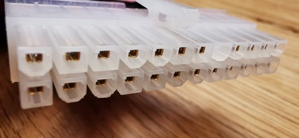

I think this is a very interesting product, as there is no need to go through a DC-ATX converter. So the ATX Molex sockets can be wired directly.
What PIN quality are the Molex connections made with? For example, I like to use gold-plated PINs. For example
Molex Part Number: 457501212
Mini-Fit Plus Crimp Terminal, 18-20 AWG, Bag, Copper (Cu) Alloy, Gold (Au) Selective
Hello,
My name is Jaroslaw and I'm responsible for Jcat power supplies. Marcin asked me to joint this discussion to answer your technical questions about this products.
We use this high quality gold plated pin's in our test rig together with high quality 18AWG wires atm.

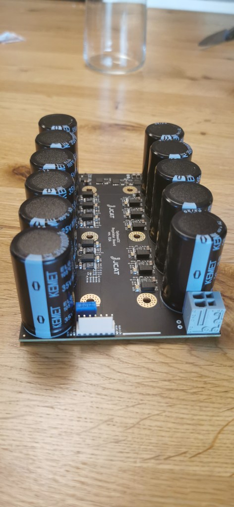

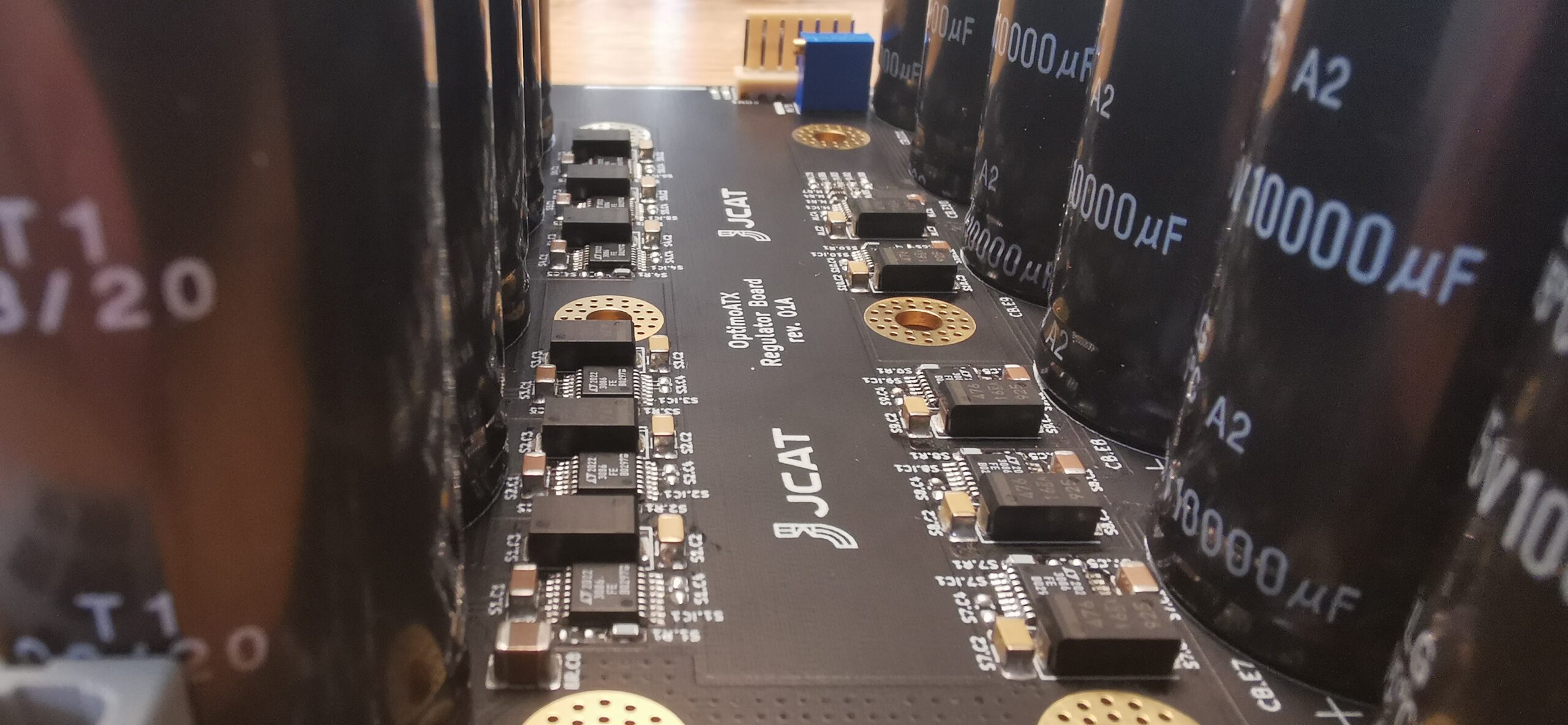

OPTIMO ATX – world’s first truly linear ATX PSU for audiophiles. We are almost there.​
OPTIMO ATX truly linear audiophile atx power supply
The heart of JCAT OPTIMO ATX PSU’s is a separate Linear Regulator Board for each power line; 12V, 5V and 3.3V, providing 23A of continuous current. Its main components are: rectifier, smoothing capacitors bank and linear regulators.
KEY DESIGN FEATURES:​
ACTIVE RECTIFIER​
For the OPTIMO ATX whopping current we designed unique active rectifier. It is using MOS FET transistors instead of diodes that are switched at zero points of AC waveform by special circuit. The MOS FET in this application has forward resistance below 1 mOhm (0.001 Ohm) – this outperforms diode resulting in much better dynamic response. JCAT designed analog control circuit with so called “floating ground” which means that there is no ground connection for rectifier at any point that otherwise might be path for introducing noise into DC circuit. This further ensures best noise performance as with GHz speed of MOS FETs there is practically no switching noise.
SUPERB PERFORMANCE​
Eleven low impedance capacitors of total 110mF (110.000 uF) will ensure outstanding dynamic performance of OPTIMO ATX. On the graph below, the green line shows output voltage. You can observe superb response for step change of load (turquoise line).
CAPACITORS BANK​
We chose high quality 105 Celcius degrees capacitors for trouble free operation in years to come, and designed in significant margin so even with some capacitance lost over time, there will be no effect on the OPTIMO ATX’s performance. Built to last, as we like things in JCAT.
LINEAR REGULATORS​
The OPTIMO ATX is world’s first truly linear ATX power supply with no switching power circuits at any point. For cutting edge performance, instead of discrete elements, we used 11 state of an art LT3086 integrated linear regulators working in parallel. In result, the RMS noise of the OPTIMO ATX is impressive <15uV. We carefully optimised the PCB layout for shortest signal path, impedance and heat dispatch.
SUPERB BUILD QUALITY​
High quality components, from resistors to connectors. Significant design margins. Gold plated 70 um copper PCB. Heat transfer elements made of pure copper. EU placed supply chain. Everything to ensure superb quality. The OPTIMO ATX PSU complies with these safety regulations: directive 2014/35/UE EMC, 2014/30/UE RoHS 2, 2011/65/UE, EN 62368-1, EN 50419 and EN-61558-1.
DISCLAIMER​
110,000 uf? Are u having a laugh? Its gonna cost 5-6k and you cant spend more on capacitors?
Hi Hieukm,
Thank you for your comment, thou I'm not sure what is your point ???
From technical perspective the capacitance in OptimoATX regulator board is doubled of what is required to sustain voltage in transient situation, like you can see on graph below, with just half of them installed.
So there is more than enough margin even if with years to come capacitors loose 20% of their nominal capacitance. There is no point to increase it even further, even from impedance perspective, and on contrary this could create additional problems with in rush current, which is quite high anyway (OptimoATX will feature soft start circuit to keep it on reasonable level).
kind regards
No point to increase capacitance even further? Take a look at Taiko or Sean Jacobs or Pachanko offering. You are really striving for quality in those capacitors? It is an insult if you gonna be offering this at 5K to be honest.
@Hieukm did you see that the capacitance (linear regulator board) is separate for each rail?
Here is a picture of the OPTIMO ATX's Linear Regulator Board side-by-side with the OPTIMO 3 DUO's linear regulator board.
