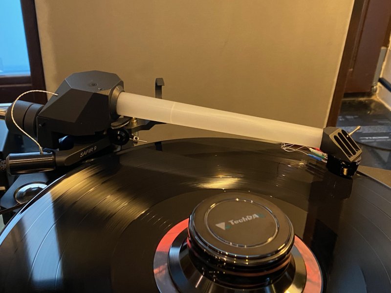

Kuzma SAFIR 9
Sweet set-up! Can you tell me have you compared the Soundsmith Hyperion that you have mounted to a Soundsmith Sussurro MKII (which I had just prior to my MSL).
Also try listening to your Safir with and without the small armlift attached, I feel I get slightly better transparency without it attached. Obvioulsy you will have to readjust the tracking force.
Soundsmith Sussuro MK II is more on the warmer side, Hyperion more on the dynamic side, at least in my former set ups.
I know the effect of the small headshell Pins from my Yamamoto headshells. Their Titan Pin comes with a small rubber ring, I might try this one on the Kuzma part, as I prefer the handling with the attached Pin.
In regard of fine tuning, at first I played around with the VTA screw on top of the tonearm.
If you adjust VTA with that screw, this screw is fixed with a certain torque. After fixing the arm height with the major side screw, it is possible to loosen the VTA adjustment screw on top.
Between loose and fix you will find the point of soft touch, which (in my set up) is the sweet point for the energy transfer.
More airy, more depth, more energy, more focus. (just a little, but audible)
Does anyone has already experience with the counterweight. Do you drill the 2 weights with force together or do you leave a space between them?
playing around, thanx to @SOS for the inspiration :)
Reactions: ashandger

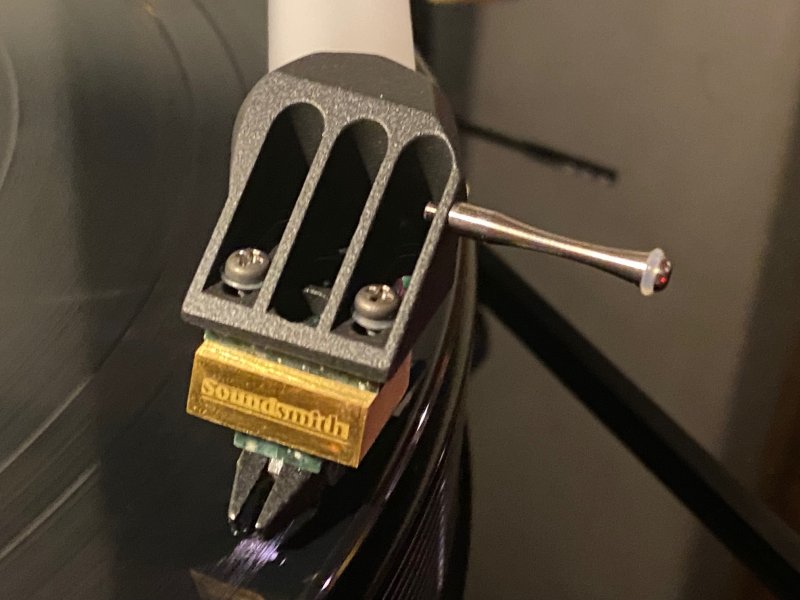

@shakti so just to verify that TY-1 Titanium finger hook from Japan fits (screws) in the Kuzma headshell? And your thoughts how it compares to the one supplied by Kuzma?
As you already heard, the SAFIR 9 sounds best without the small headshell Pin.
This is (to my experience) similar to many headshells / tonearms with detachable Pin.
Unfortunately I prefer to play records using a Pin on the headshell,
so without is no alternative for me.
Fortunately Yamamoto is offering for their Headshells the TY-1 Titanium Pin with a silicon ring to minimize resonances.
The TY-1 fits to some headshells, like Soundsmith, as well, so I tried the TY-1 on the SAFIR 9 and to my surprise it fits the arm.
Titanium on this position is less nervous and more quiet, if you add the silicon rubber ring, this effect becomes in my set up even too much. The differences are not big, but audible. By the way the screws on the picture are also from Yamamoto and from alloy/Titanium.
In my solid state / Avalon set up I prefer actual the TY-1. But please have in mind, that I am just starting to find out more about the SAFIR 9. May be after 100h or more playing / burn in time I am going to change back to the original Pin.

Today I customized an AX5G Micro Seiki gunmetal base to fit to Kuzma tonearms, so I was able to install the KUZMA SAFIR 9 to my TechDAS AF3P turntable. This will give me the chance to compare the Kuzma Arm to more other tonearms.
To do so, I installed the TechDAS TDC-01 cartridge (connected to Kondo SF-Z step up)

Why gunmetal? This is an alloy of bronze and tin ... the original TechDAS basis is made from aluminium.
Micro Seiki offered with the benefit of High Volumes their tonearm bases in alloy and gunmetal. It was choosen by turntable and Tonearm needs. Gunmetal is more heavy, so has a deeper resonance frequency, the transmission speed for resonances is higher. Aluminum ha a higher dampingfactor.
TechDAS, which is basically the continuation of Micro Seiki is offering only Aluminium bases as a reference to todays small volume production.
But still the mechanics are the same, so mostly I do prefer the more heavy gunmetal versions of the tonearmbase, mostly on heavy tonearms.
Using Glanz or Ikeda on original TechDAS tonearm bases, I do use heavy nuts ( like FR-N60) to get the weight into this position.
I tried once an aftermarket Titanium Tonearmbase, which I liked for the Axiom Tonearm.
Fortunately Nishikawa San specified AF5 and AF3 similar to the Micro Seiki RX/SX series, aonit is easy to use MS tonearm bases
