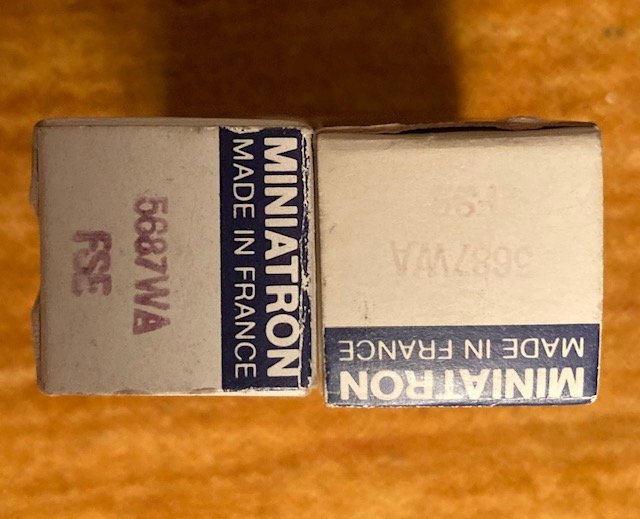

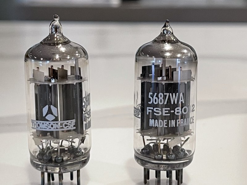

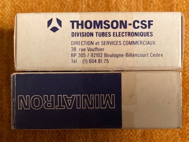

These just arrived from Jakarta. They appear to be an identical build, but one doesn't have the Thompson insignia.
And I also ordered, from Francois, "the most rare sealed lot of 3 tubes: 5687 Rayteon + two 5687CSF HF (for High Frequency) used for French army or transmission."
I must stop buying tubes...
I see Francois' fingers on the photo. He showed me that tube.i believe he had 3 of them
but it is a different CSF than the one I have
