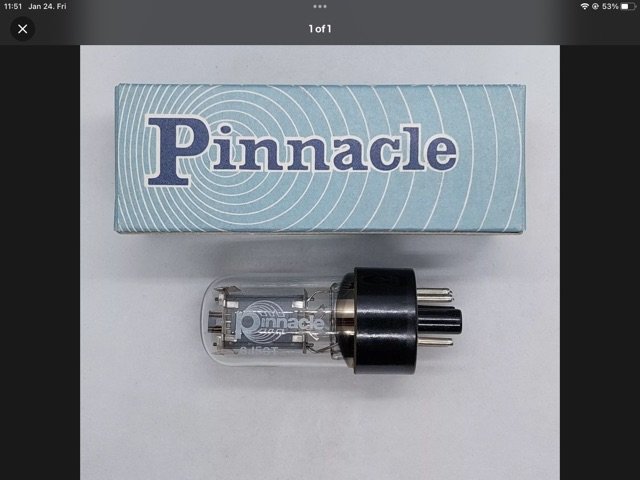

I wanted to try the 6j5 tubes in my ATLANTIC TRP (old version with the R2R board) so I ordered a pair of nice looking Pinnacle 6j5GT (CV589), which are actually 6S2S Russian tubes. When I put them in, there was this periodic loud clicking of the tubes warming up that concerned me: my other tubes only give out a couple of faint clicks and that's all but these were much louder and persisted. Then I put on my headphones to take a listen and they were buzzing very loudly. I switched it off immediately and now I don't remember if both channels were buzzing or only one, but I think both. Do you think the tubes are faulty? Ordered from Langrex.

The 6J5 should work as a native tube in your dac (meaning without the use of an adapter). It’s probably the tubes- no knowledge of their age or how they have been stored. I would inspect each pin at the base of the tube to make sure there all pins have a tight connection. Also check the glass the make sure it is not loose from the base. If all is good there try cleaning the pins with a light abrasive pad and inspect remove any debris with a damp cloth. Once they are dried try them again to see if there is any improvement. If they’re still humming/buzzing try leaving them in the dac for an hour or so powered up and give them another listen. You may be able to identify which tube is making the noise by putting light pressure against it while you’re listening. If the hum/buzz changes or goes away you may have an issue with the contacts/base. If these issues don’t clear up after a few hours under power send Langrex a note describing the problems and ask for a replacement. I’ve never used the Pinnacle 6J5 but I’ve been told that it is a very linear tube and a good performer for the money. Good luck!

Thank you very much for the suggestions. They were manufactured in 1971 and look prestine: clean and even the pins are silvery bright. Nevertheless, it occured to me that maybe a light cleaning of the pins might help, so I will try that. And yes, I also remember reading about initial hums disappearing after a few hours of burn in.

It does seem to likely be the tube. Personally, when I hear a hum, I give it a little time to clear out. Snap, crackles and pops give me the willies any time they're outside my cereal bowl. That said, if it's their first time in place, I'll give them a little time for the electrons to shake out any 50 or 100 year old tight joints or whatever, but more often than not in my experience those issues resurface. Any big or repeated pops or crackles and I sacrifice that tube to the audio gods, thank them for the opportunity, appreciate their age and ask to keep my gear and family safe and sound.
I've not heard Pinnacle either and hve no experience with their quality control or sonics. In that family, I tended to like ye olde standard straight glass metal based Sylvania 6J5G best, then G/GT or GT - all monikers of manufacture date. It's definitely nice to use tubes without adapters and there are plenty of choices! I have some ugly duckling GEC and Brimar that sound nice, too. Mellower and less dynamic, but comforting and easy to appreciate.

So how did it go? Any signs of things clearing up?
I didn't put them back in. I was afraid that even the DAC would be harmed - there was this loud periodic clicking sound coming from the tubes similar to when the tubes get warmed when the DAC is switched on, but so much louder than my other tubes. I don't even want to blow the fuse. And the buzzing sound through the headphones was so loud that I doubt it would go away.
