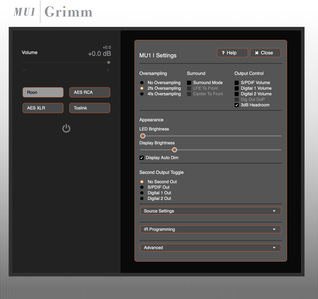

I think this may help with info for you. I powered off the MU1 and the Atlantic was off. I even pulled the power cord from the MU1 to make sure it was *off*. Then I started the DAC, waited about 1 minute and started the MU1, which was set for Roon, and directing output via the XLR AES connection.
On my iPad I opened the Roon app and hit play, and everything started working. I believe you're saying your system *doesn't* work until you flip the selector switch (or perhaps push the USB button.)

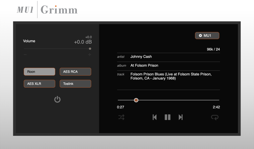

I don't know if this helps, but here are a few screen shots from the MU1 browser interface. Maybe check some of your settings there?
This next one is just with the Source Settings and Advanced expanded:Screenshot 2025-02-22 at 8.57.08 AM.png
I honestly doubt it's a configuration problem, but just to cover all the basics it's worth a quick check. Then I think you appeal to Lampi USA and/or Poland for a solution.

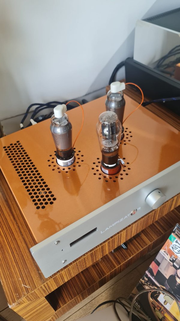

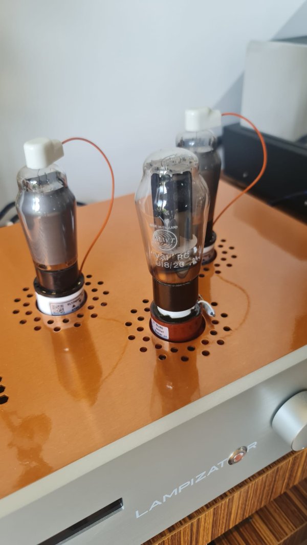

So I thought I’d put this one out there as I’ve just got it set up. Here’s my TRP3 running a quad of 2.5V tubes- Philco mesh 27’s. I was able to get the voltage interface finished this week but my first try was squashed by a bad tube. I received replacements today and am up and running. These old triodes are something completely different when compared to the others I’ve been using with this Dac. I’ll be getting thoughts together as I get more listening time with these but I can say having the ability to run varying voltage tubes is a great thing with the TRP. More to come…

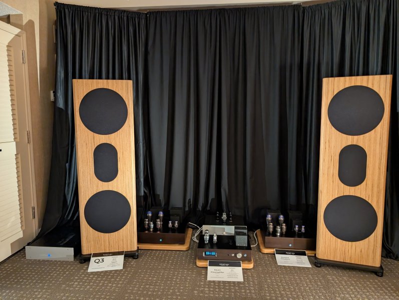

To all WBFers at the Southwest AudioFest 2025 here in Dallas, we invite you to come hear the latest iteration of the Atlantic DAC, The TRP 3, fed by a LampizatOr Gulfstream server, in fantastic setup we are demonstrating with new show partners.
Please visit us in room 1107 as we exhibit this piece on Spatial Acoustics speakers alongside of the debut of Don Sachs latest amplifiers and matching preamp.
To say this system overshoots is pricetag is an understatement.
Hope to see some of you here!
Fred A.

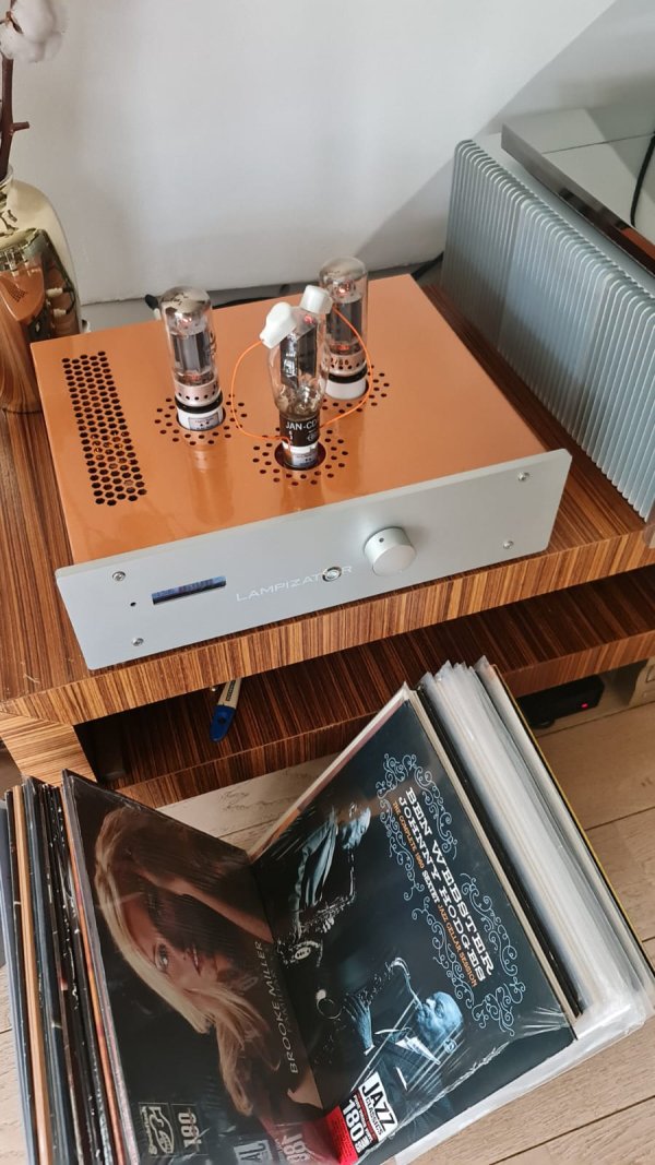

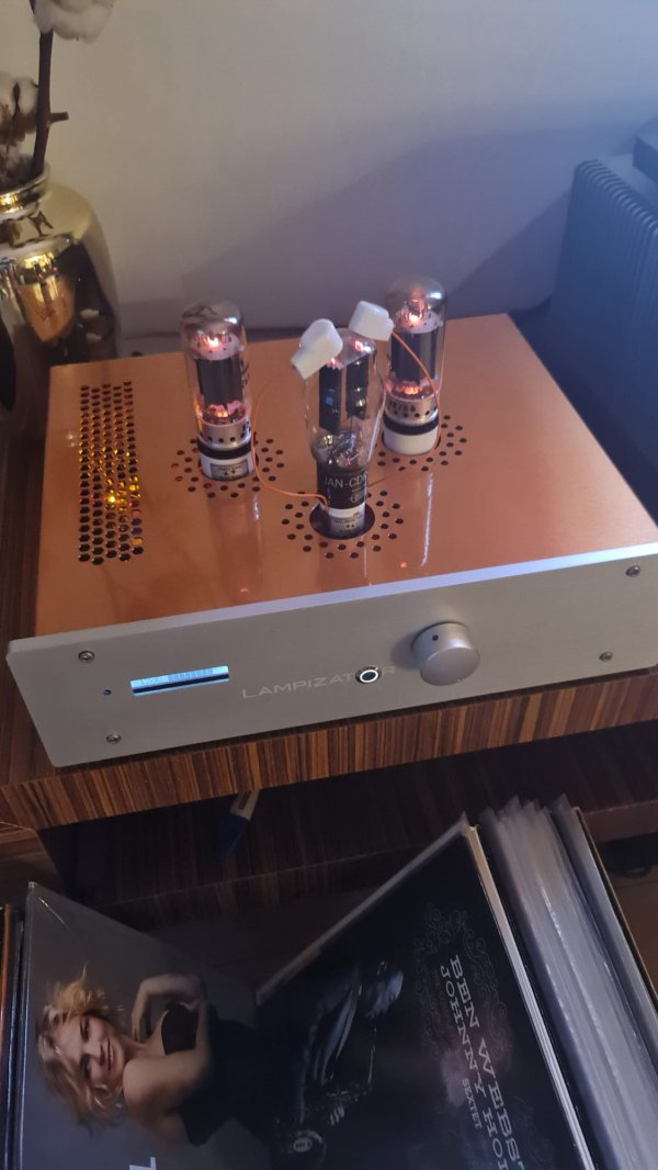

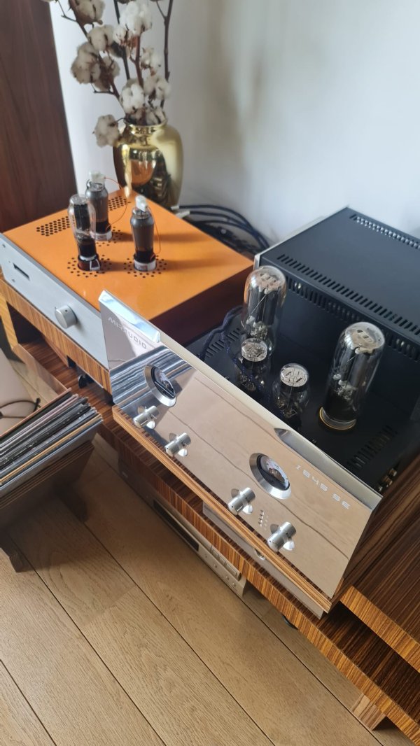

Hello, I'm new to this forum but for a long time in this noble hobby .As a happy owner of Lampizator Golden Atlantic TRP for more than 3 years (thank to @Golum), I want tot express my observation on above mentioned subject. In my humble opinion, for my system at least, best combination of tubes for Lampi TRP (tried at leat 30 combination) are as follows:
1. U18/20 rectifier (any brand), EL 12 spec Telefunken output
2. U 52 Brimar rectifier, F2a11 Siemens output
3. USAF 596 rectifier, Tesla 4654 (very close to this is Tesla EL51) output
I just recently acquired EL 34 Winged plates single O getter par Ulm, and same but double O getter by Telefunken, so I will test in next few weeks both options with different rectifiers. Different options showed In att.
Cheers Boris
