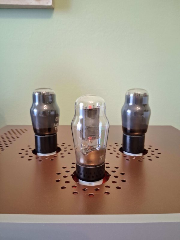

This picture shows a Wizard type 80 rectifier with a pair of STC 2C26a triodes. The STCs are likely more common in Europe, incidentally. IMG_20250316_145807.jpg

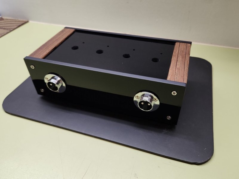

Hi fellow TweRPs, I thought it was time to do a brief update regarding my original post, having rebuilt my outboard filament power supply with some convenience mods.
Original Post
For fun, I'm calling the project box the Voltinator™. The ™ is just a joke; I invented nothing and have no interest in selling anything here.
I decided there was no value in having both barrel and aviation connectors on the front and also decided a single switch on the rear of the chassis for switching the output voltages was preferable over the two switches on the front (one for each channel). The aviation connectors I had used were kind of a pain in the neck from a mounting perspective in the 1/4" acrylic. So I swapped them out for ones with a mounting flange.

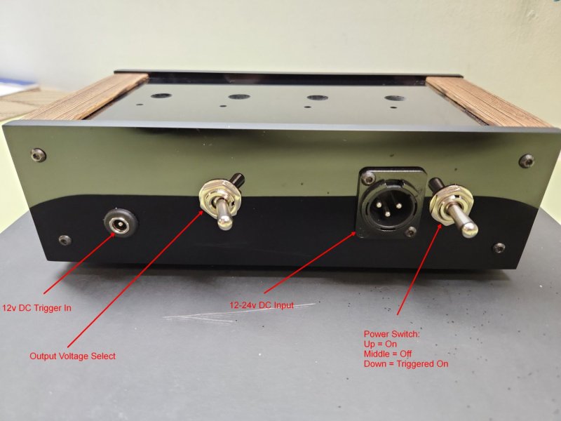

The back now has a single SPDT switch determines which of the two pairs of buck converters gets power - one pair is set for 2.5v and the other pair set to 6.3v.
I swapped out the power switch for a DPDT and integrated a simple 12v optocoupler to provide an additional power-up choice: input trigger. Pity the Lampizator doesn't have an output trigger option, but my preamp does.
Now, you might well wonder why I would choose to have 6.3v as an output option when the DAC itself sends 6.3v to the tube socket - so why use the Voltinator™ at all for 6.3v tubes... True, and originally I had 2.5v and 3.0v as my output options. I really like the sound of the 2.5v type 27 tubes, they are some of the best sounding options I tried in the TRP. I have a small number of 3.0v tubes I have yet to try and I'll get there eventually, but one of the things that really stood out by not standing out was the pitch black background. Wow, were the 27s ever quiet! Now noise has never even been on my radar with the TRP and I've always marvelled at how clean sounding and pure it is. But there was something almost eerily silent about the 27s and how that increased their apparent dynamics.
@Designsfx , who is similarly experimenting with outboard filament power, and I compared notes and postulate that this "extra" silence may be a function of the outboard filament power. Whether due to removal of that load from the Lampi or isolating that power circuit outside of the TRP chassis, we didn't know, but it was worth a try. And, as it turns out, I do have several type 37 tubes and these are very nearly the same as the 27 except they are 6.3v and consume demand less current...

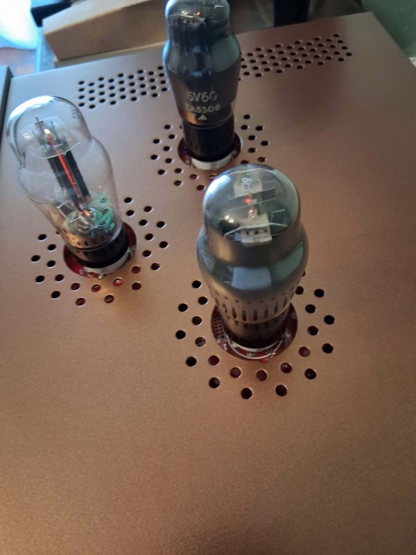

While it is well documented that with bigger plate tubes you get a “bigger” sound and I do have a few favorites in that big tube realm, for this segment of Atlantic tube adventures I’ve thought of giving the smaller bottle 6V6 family a spin.
I tend to think of this as a European tube road trip of sorts, where I’ll try to wade through 6V6’s and various rectifiers of European manufacture with the soundtrack consequently being a bit more Kraut rock than Grateful Dead (“Europe ‘72” will however be the playlist).
As a point of origin, let’s choose Great Britain, although to set the scene, first comes an Anglo-French cooperation: the GEC 6V6G partnered with a French made Philips 5Y3GB. The sound of this combination is delicate and slightly ethereal but without losing any of the signature punch of the Atlantic.
Some pics:
