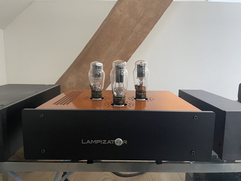

At the suggestion of Lucas Domansky, I've switched EL51s in my TRP to Siemens F2a tubes. In my opinion (and Lucas’ as well) these tubes are fantastic in the TRP. Tonality, presence, and bass control are where they especially shine. I like them even more than the Tesla EL51s. Has anyone else given these tubes a try?B968DFB9-5141-4705-9ABC-02AB75C3B051.jpeg
Read too quickly on my iPad Mini. I know a few rectis go for a lot, but 309 Euros each (USD 357) + shipping is well above average for that position. For example, I picked up the pair of EL51's from Lucas for $142 total shipped.
Well, this is “What’s Best Forum”. And right now my opinion is that the F2a tubes are the best in the TRP. Others might well disagree, but the price of the tubes is not at issue.
