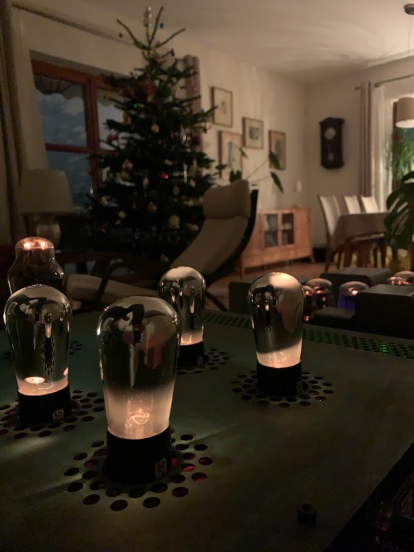

That said, since few days I enjoy not only the warm light from Christmas tree, but also from quad of RCA UX-201A. What a nice alternative to beloved RCA 45!

What setting do you use for the RCA UX-201A‘s? The 45 heater setting?
No, it is not the 45 setting.
I don't have heater switch with many adjustments, just a toggle to choose between two. During Engine11 upgrade I asked for a change from setting "300B" to "01" tube familly. At the moment my toggle works "45" vs "01" and I'm sure, those two are not the same.

Hmm. In a previous post, Golum suggested the 300B setting for the 101As. I assume that works for the 201As as well?
As said in PM 112a/01A/201 have 5V heater same as 300b hence you need to use 300b setting.
