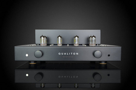

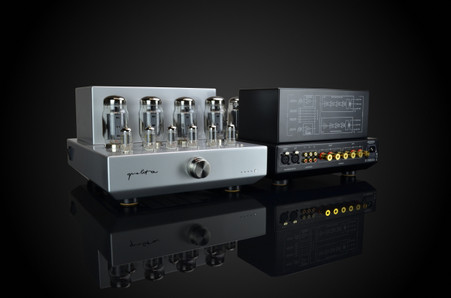

Note that there are pre-owned tube power amps in your price range (and likely with enough power) for sale at Audiogon from Audio Research, Audio Hungary, BAT, EAR, McIntosh, VAC, and Zesto.
Is Audio Hungary any good?

I agree with you 100%. I have narrowed it to Audio Hungary and Music Reference 200. Also if my buddy decides to sell his VTL I will take it off his hands.
Music Reference is excellent. Audio Hungary... will it drive 4 ohm speakers ok?
