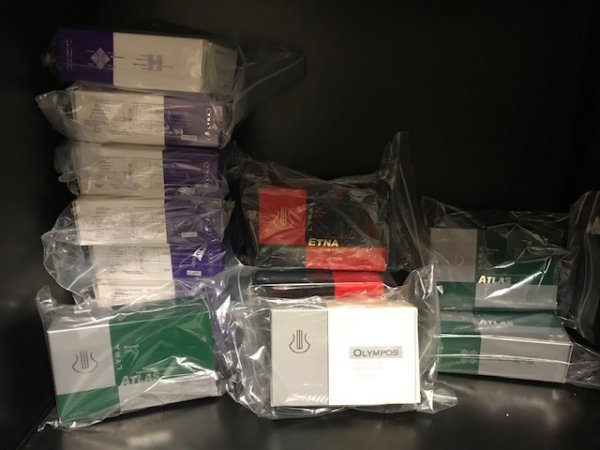

The last Olympos in the world,
new from Audiograffiti,Italian distributor
Audiograffiti Lyra stock,saw today
