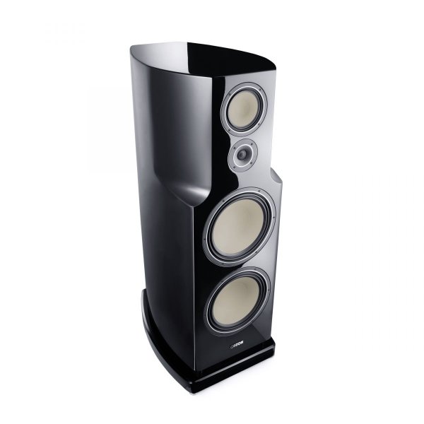

My Alltime favorite Canton RCL

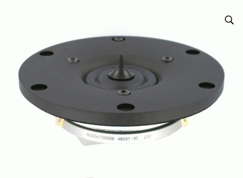

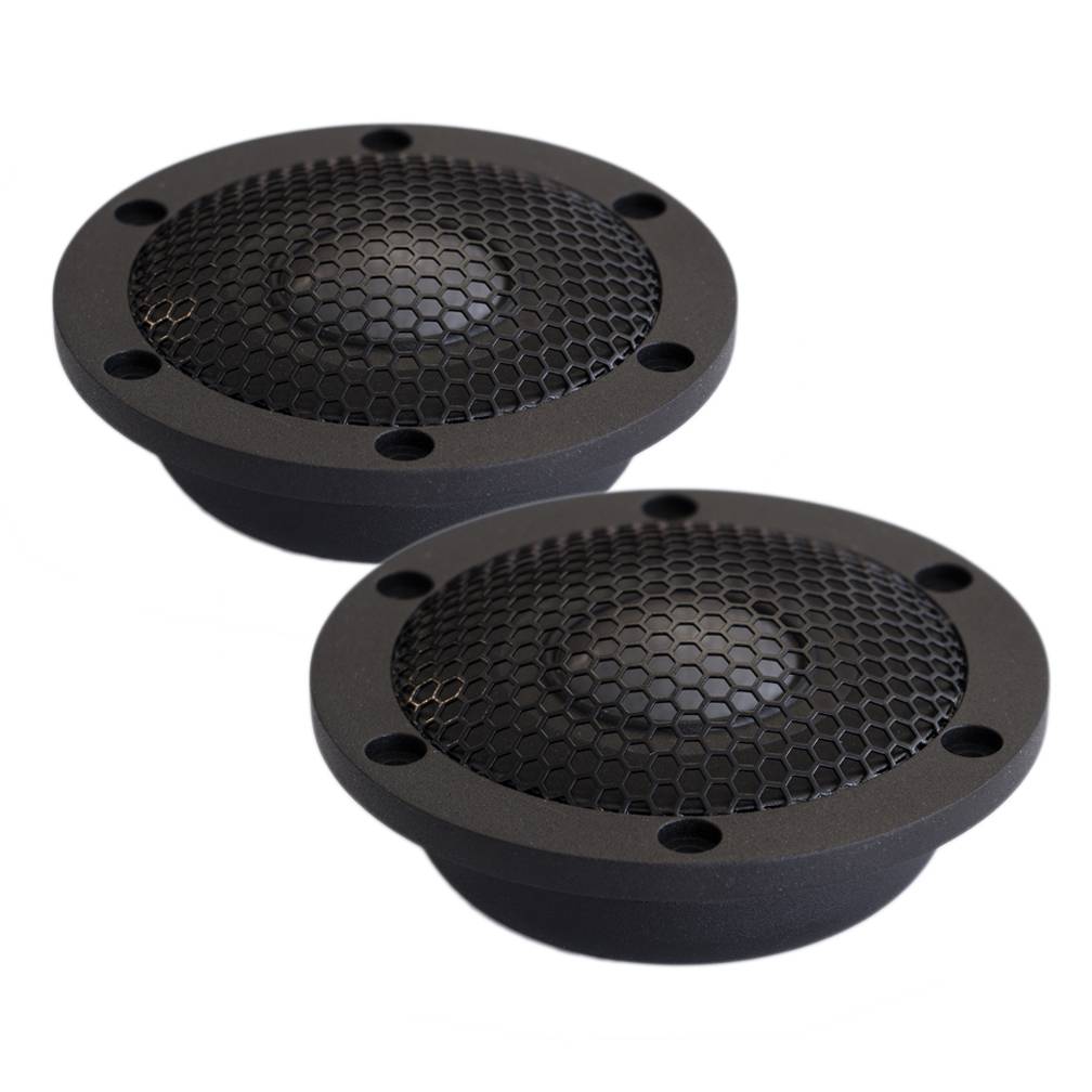

Regarding " wilsons" soft dome tweeter its most likely a scanspeak design.
The Tw i like most is the scan speak ringradiator design , it sounds more at ease then the soft dome version due to its pierced membrane connected to the aluminium wave guide / phase plug i reckon.
It also has a slightly lighter moving mass 0,3 gr as compared to 0,4.

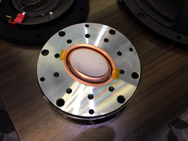

I thought about using the new tw with eliptical voice coil but FR wise the 28 mm doesnt look that good .
The 38 mm looks much better

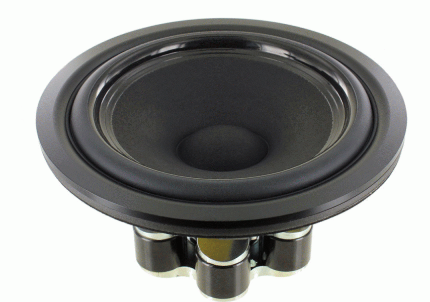

I will use the 18 cm midrange with elliptical voice coil ( quit expensive ) to try and up the performance , possibly a more natural sounding paper composite membrane ,with better transient response and a slightly higher eff.
