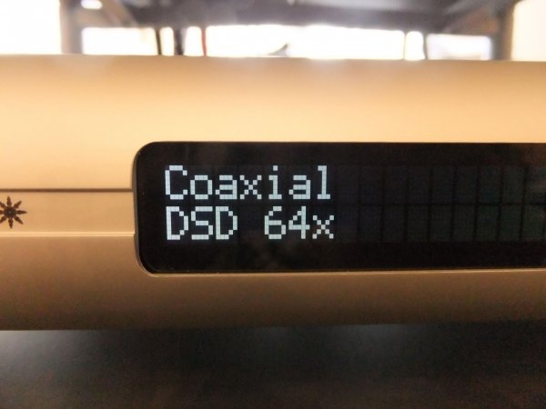

Native DSD signal can be sent out via an Asus Xonar soundcard's coaxial digital output and accepted by coaxial digital iutput of my MSB IV Plus.
I tried both HQPlayer (Linux) and JPlay & Foobar (Win7) successfully.
Here is the photo:
That is a different issue. You are not spinning a SACD disc so there is no licensing restiction. A SACD player cannot output unencrypted high rez. Soundcards are not a problem.
