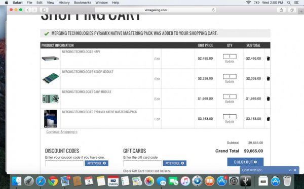

All you would need is the Hapi to have 8 channels of ADC. The Horus is the same thing with 2 extra expansion slots. unless you need 16 channels of ADC/DAC, you don't need a Horus. You also should consider that you can pop the DAC board into the Hapi that's the same board as in The NADAC that gives Ian's uber high end vinyl rig a run for the money (preferred by his friend). Total cost for Hapi, ADC/DAC and Pyramix mastering pack is under $10000. And you would have 8 channel capability. Everything in 1 box. You could sell the GG for more than that and have the whole system.
Vinyl rippers dream system. If you want to add additional warmth of tubes, do it on the analog end, or in the preamp. This system will be able to produce an indistinguishable replica of your analog rig all with 1 box ADC/DAC. You can't ask for better than that.

You are forgetting about the $20000 DAC you have in the picture with the Tascam. You wouldn't need it anymore with the Hapi. You could sell it, own all of this, and still have change left over in your pocket. Even run a home theater setup with the extra 6 channels.
The Horus allows you to do Surround mastering, plus, since it's bigger, has a different PS. Then you have the problem of getting a compatible Win 7Pro system and learning the software.
Plus, you need to get the Native PRO Mastering Pack for the higher Sampling rates, which is more $$.
But for Bill's application, he's not going to be mastering surround mixes. The Hapi has an external DC input if one wanted to upgrade the power supply. The power supply is probably only bigger because the extra 2 boards will require more power to run. Both are SMPS's. SMPS's are perfectly fine when you use LDO's and circuity with very high PSRR. This is why we are seeing more and more DAC's using SMPS. They put the DC input on the back so guys who have a bias to the buzzword of LPS's, can use an LPS with it. This is when they will likely find no audible improvement.
Yes he will need a PC with Window's pro installed on it, but I'm sure he has this already. And yes there's the learning curve, but I'm sure he could figure it out. Everyone else did who bought it. Takes dedication if you want to raise the bar. Nobody said going this route was for the average audiophile :)
I am clearly too lazy for the Merging route. The raison detre of the Tascam is ease of operation for me and lack of even having to try hard yet still get a darned good result. No computer - just cf or sd card is huge upside for me.
I don't have Windows 7 pro just standard Windows 10 and honestly I don't want to muck about with my computer doing this - it is too painful. I used to do this with a Focusrite and audacity - lol - cheap version.
