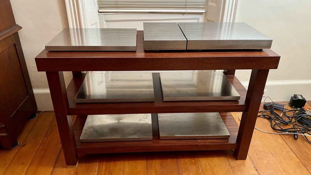

David and I designed an isolation solution to separate the top shelf from the rest. His Nothing Rack is a more sophisticated alternative full of interesting technology. This is my DIY approach.
My new rack (48"W x 20"D x 29"H) plus two amp stand platforms were delivered a couple of days ago. They are made of Sipo wood stained a dark mahogany. The top shelf is 3" thick, the two lower shelves are 2". I am in the process of grinding and polishing the 1" stainless plates to a pretty high standard. Note the reflection of the Vitavox in the amp stand. There are nine plates total. The rack weighs about 200 lbs. It will support seven steel plates weighing 600 lbs plus 400 lbs of gear. The 225 year old floor is reinforced with a steel column in the basement directly below each of the front legs. The rack is extremely strong and solid. Leveling on my uneven floor boards will be achieved with matching wood square/flat shims of varying thicknesses.
This rack and stands will fit in with the decor of the room. The rack is larger than my existing rack which I built for the Pass gear, but 2.5" shorter. I wanted a horizontal look, so it is low and wide. This needs more clearance for the Lamm tubes, so it has three shelves instead of four. I will set everything up next week when David visits.

Here are some photos of the new rack and two amp stands. David and I spend a couple of hours completely dismantling the old rack and gear and setting everything back up. The rack is leveled with shims made from the same Sipo wood. It is extremely solid and stable. We repositioned the two steel columns in the basement to be directly under the two front legs of the rack. The total weight of the rack fully loaded is about 1200 lbs.
The two steel plates on the bottom shelf are not yet polished. One can clearly see the difference in the reflective surface. David did recommend different amounts of dampening between the plates and the wood shelving. The plates under the turntable are treated differently than are the five plates under the phono and pre amps. The amp stands are also slightly different and they do not rest directly on the wood floor. David made suggestions based on what he heard from the old rack.
I am very pleased with how this DIY solution turned out. It looks nicer in the room and I think sounds slightly better than the old rack. It also functions better because it provides more spacing for ventilation of the tube gear.
