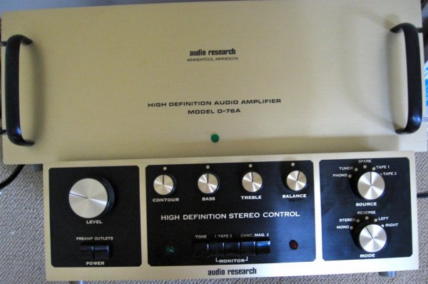

Here is my latest concoction- an Audio Research SP-3 tube preamp converted from RIAA to NAB. The video was shot earlier this evening. The tape deck was my old reVox C270 with Nortronics play head directly wired to the SP-3 tape(ex-phono) section. The test tape is a 15 ips NAB MRL tape and the results are shown on a Hewlett-Packard Spectrum Analyzer. Sorry about he fan noise- it is coming from the HP.

Ki-I believe you are correct in that he converted the phono section from RIAA to NAB. The SP-3 isn't old enough to have tape head inputs.
I did convert the SP-3 from RIAA to NAB eq.. I removed the complete RIAA network and installed a new board with the appropriate NAB network with two 15 turn trim pots at the 3150 hertz turnover(+/- 3 db). I will likely get an IEC and RIAA board made up and possibly an AME board. These will be installed on a pair of 4 pin sockets. The only series of ARC preamps to have NAB playback eq. are the SP-2 series, which I believe was sold up to about 1974.
Last month I had a stock MX-110 McIntosh preamp that had NAB eq. built in. It was very lovely sounding but a bit too noisy for my taste. The SP-3 is considerably quieter with my 200 mH Nortronics play head, but is lacking in 'punch' and 'slam'. It certainly is much quieter than my Bottlehead Seduction and about the same noise level as the Tape Repro, which I have to admit had WAY more slam. I'm listening to it right now with the Chopin first piano concerto with Graffman/Munch/BSO now and it is very nice. I really miss the King/Cello preamp, which I think has slam/punch in spades as well as a super lush 'tube' sound with an awesome soundstage and SUPER QUIET. CK- please get going on serial number 14 :)
Next move on the vintage preamp/tape lash-up front will be trying some 1:15 step up transformers or some high impedance heads, a la Ampex 350/351, which were almost 1 Henry! This will certainly supercharge any old preamp. My old Presto 825 is getting restored in Seattle now and my restorer has some 351 transports, so that might be my next move.
To sum up my findings so far- 43db gain in tape is not enough for good results with modern 100-250 mH heads. I have found that around 50db is right for the modern heads. Kara has gotten around this problem by having a solid state 'step-up' stage before her tube gain stages. Ampex (MR-70) and Studer(some A-80s) used transformers to step up the level. I used an MR-70 in the 80s/early 90s and it was a gem. Will be trying the peanut Beyers and some UTC LS in experiments later this year.
