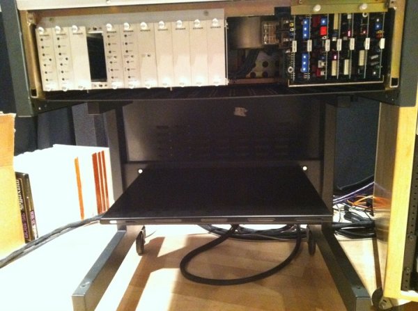

Here's a cool idea for anyone with A80 machines. I was running out of rack space and usually use a dedicated A-D converter whenever I transfer tape. I'm sure some of you saw a tape pre teetering on top of my meter bridge at one time. Here's what I did. I had extra Raxxess 19" shelves that I wasn't using. I don't like the lip on the front, so I turn them upside down in my racks. Well based on that, I took the center brace from the A80 rack and bolted a shelf on using 1/4" x 3/4" machine bolts so I can place an A-D converter or even a tape pre. I've done this to all my machines now. Take a look. Pretty cool!!
Hi Bruce,
Thanks for the great idea. I had some old middle atlantic shelves laying around, they fit perfect.
Now I need to order some more Wave Kinetic a10-u8's for under the components.
